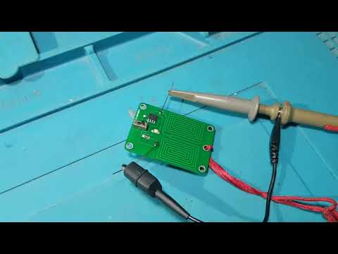

What is this?

      Hello , i think, it is a schumann wave generator! 7.83Hz
          esoteric matter. must harmonize your aura/vibrations LOL!
            You know, I'm wondering if it's one of those devices the woo-woo crowd buys to ward off evil radiation. It seems to have a lanyard for hanging on your wrist.
            "*NEW* Electronic Device produces a protective aura around your body and blocks harmful radiation from power lines and cell phones. Also neutralizes government tracking devices in your paper currency and credit cards. ONLY $99.95"

                So, seems Alexismex was right or closest to truth.
                Some kind of trivial nonsense device that somebody lost in a park.
                I can imagine the sadness at that person!
                I keep this for few months hanging at my workbench infront of my eyes, not having time to examine it.
                A friend and his spouse founded it in a park and gave it to me.
                We all thought it is some "anti flea" repellent device for dog or cat.
                All the time the "antenna" was most itriguing for me.
                I was wandering how can i reuse the antenna and make something of it.
                But same as KT315; i was thinking on very high frequencies.
                In meantime i tried to "measure" it with HAM radio, later with SDR dongle (SDR Sharp spectrum analyzer) and than with simple f. meter.
                None of those catched anything from it.

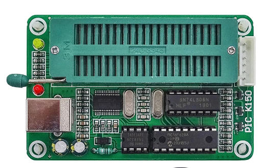

                  Can i reuse PIC?
                  I am not familiar with late models, later after 2001. (last time i did anything with PIC's)
                  Can it be re-programmed?
                  Recently i bought this programmer: Click image for larger version
                  But i can't find this PIC on the list.
                    Yes, the PIC is reprogrammable. Ones with xxFxxxx part number are Flash memory devices. Those with xxCxxxx are older one-time devices.
                    So unless someone has gone to the trouble of burning out a bond wire, it should be OK.
                    https://www.microchip.com/en-us/product/PIC12F1501

                        Yes, as Skippy said the F (Flash) parts are re-programmable.
                        They do not have a burn out bond. Just Read protections configuration bits.
                        If not read protected then you can read out the code int it. Otherwise you just erase everything and re-program.
                        I use a 12F1501 for audio tones in my HH2 detector (see https://www.geotech1.com/forums/show...ake-on-the-HH2).
                        Needed the PICKit3 programmer for this chip. Older programmers do not support the 12F1501.
