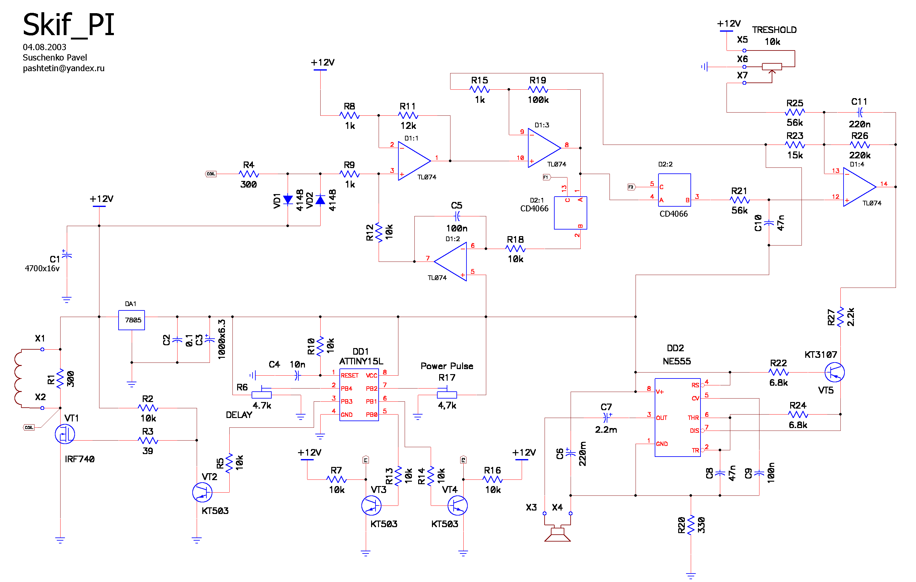

    New good P.I. detector .
    Skif_PI.hex file look my site.
    No comments...
    http://sevzirfo.narod.ru/

    nice schematics, but what is ATTINY15L, is it from german detectors, or is it possible to use something else?
      Re: SKIF_PI
      It is a micro from ATMEL
      1-Kbyte In-System programmable Flash Program Memory, 64-Byte EEPROM, 32-Byte Register File, 4-channel 10-bit A/D, Up to 1.6 MIPS throughput at 1.6 MHz. 3-volt operation

        thanks a lot,Billy, so if it is micro, then must be a program to write to .....
          Re: SKIF_PI
          Yes I saw in his website the hex file, it is the last link called Skif_PI.hex
