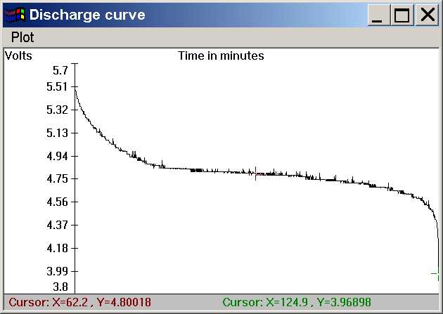

          Here is a graph of a 4.8 volt NiMH battery discharge voltage showing the spikes and dips. The dips can be much worse in an alkaline battery, whose voltage will fall off at a greater rate.
          Take note this NiMH battery begins with a full charge of 5.5 volts then quickly drops to a range that holds between 4.8 and 4.5 volts. after that it finally decays as the charge is depleted. When this battery drops to 4.0 volts (or 1.0 volts per cell), the battery is done and needs to be recharged or you run the risk of causing one or more cells can reach a reverse polarity condition. This may help show the usefulness of a regulator.
            A good filter between battery and regulator should keep your regulator output nice and smooth.

                Brian,
                Just for information, the discharge curve in J Players post above looks like it's the second image at http://shdesigns.org/batts/battcyc.html To quote from that web page, "The small spikes in the plot are due to noise in my meter circuit (design is a prototype.)". So the spikes and dips (i.e. noise) on this curve are not generated by the battery.
                I'm no electrochemistry expert, but it is still my understanding that batteries do not produce spikes and dips which are not due to load fluctuations. So lithium-ion batteries, lead acid or any other technology don't produce noise and so are not different in this respect.

                  1. You are right about the curve. That battery was not connected to a constant load. In the graphic, the load was removed for 1 second before taking each measurement along the curve. Whether the meter caused the noise as stated, or it was the battery voltage recovering from the load, I am not sure.
                  A battery connected to a fixed resistive load with a voltmeter attacheded does not show any significant dips or spikes. The circuitry connected to the battery causes these dips and spikes. When charting the voltage of a battery "in use" on a metal detector, the spikes look sharp like noise when they are compressed into a chart of the full discharge time of the battery. If you were to look at a magnified portion of the voltage curve covering a 5 second period, you would find that the dips and spikes are more rounded and look less like noise than when shown on the full discharge time chart. The point is that internal resistance of the battery will determine the degree of dips and spikes caused by changes in the current drawn. Sorry if I caused any confusion.
                  2. The headroom for NiMH and Li-ion works out very well because they have a pretty flat discharge curve. If a 6V NiMH battery drops to 5V, then the battery is at a point where almost all the usable charge is used up, and the battery needs to be recharged in order to avoid the risk of cell reversal. The same is true of Lithium ion batteries, except the voltages are very slightly different. Alkaline batteries have more of a slope to their discharge curve, so the headroom issue is a real problem.
