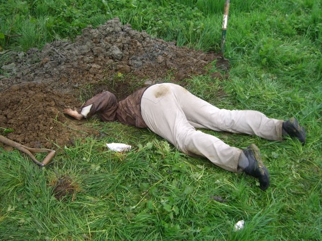

    I've been away all this last week, and am just catching up with things on Geotech. It seems that the long-haired metric vegan ******* was correct then.
    Actually, I know this guy who dug the hole, and these tests on Gary's site can be trusted. Anyway, Carl's findings are confirmation. The results are quite surprising.
    It will be interesting to see what the Gemini 2-box can do.
    By the way, here he is again digging an even deeper hole - over 1m deep!
