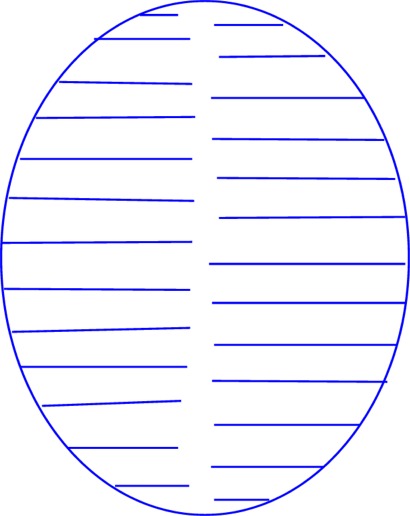

                As a followup on the reflective Mylar I mentioned earlier in this thread, I found out that it will work fine if cut in a strip and used to wrap the windings, like what is normally done with lead foil or other foil tapes, but it is a little too conductive if used as a full solid piece the size of a 11" coil housing and the delay is at 10 usec or less. It is slightly detectable and could cause too much droop. Now, this large piece apears to work and appears to be invisible at something between 15 usec and 20 usec, depending upon its size.
                Now as a followup, I did take 11" round large solid piece of the reflective Mylar which was about the size that would fit and cover the bottom of a solid 11" round coil, glued this piece of Mylar to a piece of thin plastic, and then made simple slice type cuts in the Mylar with a utility knife. Now, the Mylar is still one complete piece but now has thin slits, something like spokes expanding out from the hub. Now, there is no one large solid piece but all pieces or strips are still connected. When this was done, the stuff became invisible again when tested with the PI ieven below the 10 usec delay range. Care must be taken to make sure to not cut the Mylar piece completely and it is still 1 piece. but is not a fully solid piece now.
                I did this with an elliptical shaped Mylar piece also. In this case, I glued it to a thin piece of plastic also and then simply made cuts in the Mylar perpendicular to an imaginary center line down the long side. I offset the left side and right side cuts to assure the Mylar piece was never cut in two, but was simply slotted on both sides. The result was the piece became invisible to testing at less than 10 usec also. I have attached a very crude simple pic of what I mean on the elliptical piece. The pic is crude for two reasons. First, I am lazy and second, the cuts do not have to be precise. They just have to break up the surface of the mylar film but not cut the Mylar shielding into multiple pieces. If the Mylar is cut into multiple pieces, only the piece connected to the wire will act as a shield.
                Now, once the shield is made, it can be tested by passing it over a working detector. If it is still detectable, one can simply add more slits to the Mylar. They do not have to be as long as those shown in the pic, but just simple slits that break up any larger surface areas of the Mylar material.
                The wire needed for connecting the shield to the ground lead had about 2" of insulation stripped from it and the bare portion was taped to the Mylar along the center line using a good quality tape. Now, if for some reason the Mylar film does get accidently cut in two, a jumper can be placed connecting the two pieces using a similar wire as what is used to connect the ground conncection to the Mylar tape. So, there is no need to panic if the film is glued and then accidently cut in two.
                I plan on trying to simply glue the Mylar to the inside of the coil housing and making the slits while in place. This will simplify things. If the slits are close enough and the shielding is "invisible", then flexing of the housing shouldn't generate a false signal. However, it is a good idea to fill or at least coat the bottom of the housing with epoxy, two part foam, or some other lightweight solid filler.
                The use of the metalized Mylar for shielding appears to be simple, reasonably inexpensive, and effective.

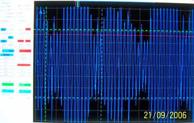

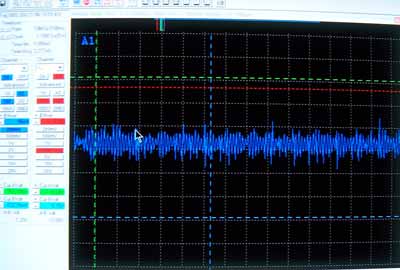

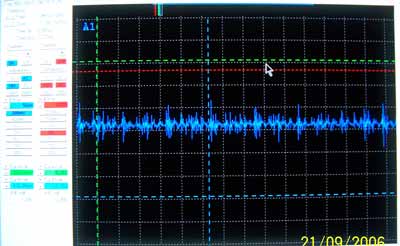

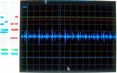

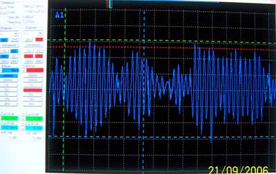

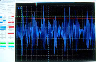

                  Coil shielding
                  The following pictures explain the importance of shielding the coils.
                  Coil with 310uH, acts like an antenna and picks up electro magnetic waves from the environment.
                  # 1 coil with no shield and no cable
                  # 2 coil with no shield and no cable and with my hand on the coil
                  # 3 coil with shield and 2 conductor shielded cable
                  # 4 Coil with shield and cable and my hand
                  # 5 coil with shield and cable and ground
                  # 6 coil with shield and cable and ground and my hand
                  Settings: 5uS div and 200mV x10 div.
                  Tinkerer
