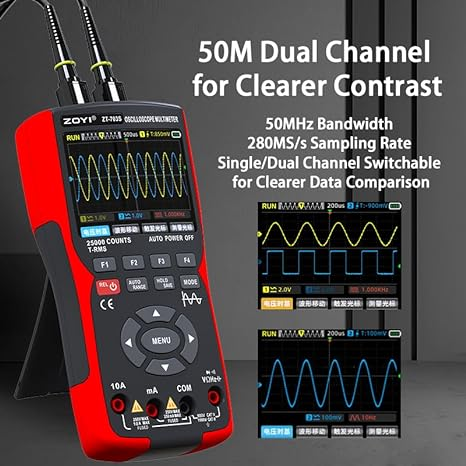

    Okay, tech guys and gals, would this be a good scope/tester to have?

    https://zoyitools.com/product/zt-703s/
    Knowing how much I like to measure frequencies.
    It's almost halved in price - probably has a sales problem due to the low sensitivity - 20mV/div , but it works for your purposes
      Any is better than none.
        What all would - 20mV/div affect if I used the unit for other than detector frequencies?
          Keep in mind this is a DMM with a little bit of oscope functionality added. Depending on what you want to do it may be enough, but I would not expect it to perform like a real oscope. 20mV/div is the maximum sensitivity, again it all depends on what you want to do. I rarely use a higher sensitive setting, but just recently I needed 10mV/div with 256x averaging to look at a response. If all you want to do is measure frequencies and see what a waveform looks like, this might be all you need.
