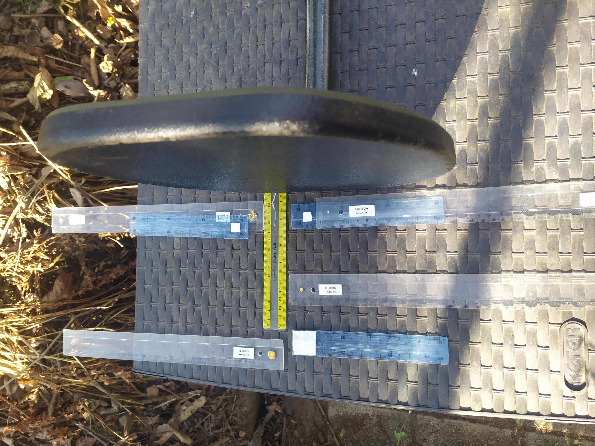

Standard targets
    Obviously good method.
    Come to think; what if single pulse is shot, say 100uS width and than immediately cut off, providing the oscilloscope with at least 5uS sensitivity and hold function (my middle class scope have 1uS sensitivity and 0.2-0.5uS x10 uncal).
    And then just hold (freeze) complete decay slope on the RX side (my scope is not having this... or I have no clue how to do it! lol)
    There must be way to "trick" this somehow and get most precise calc.
    Some pc based scopes have nice hold function but sensitivity is close to useless.
    You mentioned "overload" and that's a bit confusing for me, aren't there clamp diodes at the input? And the RX opamp can have offset adjusting feature.
      If you have an analog scope it cannot hold the waveform. For this method, you also have to be able to save the oscope data points. This requires a digital scope. An analog scope could be used with a log amp, as Green described in a prior thread.
      The purpose of the diodes is to prevent the preamp from burning up, it will still overload. An offset won't help, the signal is just too big.
        Carl, I get what you are saying now. You can calculate the tau any where along the linear slope.
          As I afraid... and the digital scopes with good sensitivity are usually not affordable for modest budget hobbyists... aka me!
          About the clamp diodes I understand... ok I see, thanks!
          So the best tradeoff would be super fast opamp at the RX, right... again "catch 22" for the modest budget hobbyists!

                it is clear that the standardization of test targets is a good thing if the results are to be shared with other testers.. I also adopted the goals from the geotech1 forum for my testing..
