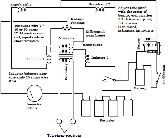

    In the pic, the man has in the hand a pushbutton for to put in operation. The consumption in good adjustment point is near 2 A! And this is not balance/induction type, hope is two coils PI balanced by rheostat. The detector consist in:
    2 exploring coils
    Rheostat
    Inductors
    Transformer: 2 primaries, 1 secondary
    Ammeter
    Switch
    Telephones (high Z)
    Buzzer
    Batteries
    Pushbutton
    No tubes, no heavy weight, etc.

    I think the circuit works like a RUMKORF transformer using a vibrating switch to generate strong magnetic pulses (like in Marconi and Hertz experiments).
    The vibrating switch open and close the circuit on TX stage...then something is used to reveal the induced (Lenz law) voltage variations on Rx stage.
    It's not a RUMKORF with iron core and overlapped coils but with no core (would be the target) and distant coils (TX and RX) , or simply overlapped also but with no core.
    What I don't understand is receiver section...telephone --> means some audio tone generation due to the coupling of TX and RX...but can't work like what we have (sampling, diff. integrators, etc) but most likely a beat frequency oscillator drived by some etherodyne style detector --> so seems
    it have to not sample after delay but also "convert" rx signal in CW bfo style
    detection.
    So I guess it would be something between a real PI (modern type) and a BFO, but really don't know for sure.

                This kind of terminology, time domain, sample, etc., doesn't exist at this time, but these pure electric metal detector can be considered as an early PI type.
                In this circuit there are an electric balance between 2 coils and two small inductors attached to the trafo, called inductor balances, few turns.
                If isn't BFO, PI, induction balance, ressonance-off, so, is electric balance-PI? or what? In wich place is?
                Maybe Eric and others can use this principle for his PI!
                The schematic:

                  Hi Esteban,
                  - buzzer is actually a relay as I see in self-commutation mode (f osc. is determined by spring constant and magnetic field end other stuff)
                  - buzzer screw can vary operating frequency by some decade hertz
                  if too closed buzzer doesn't buzz...a short circuit and one cookes the coils
                  with 10-12 amperes
                  - rheostat/ammeter circuit used to limiting the operating current
                  - primarys are in opposition so a nulling "primary" voltage act in normal
                  conditions according to lenz law
                  - inductors are needed to nulling minor asymmetries in primary stage
                  - secondary drive directly the "thelephone" (hi-z earphone old style)
                  Seems a rumkorf like schema like I said, but with double primary in opposition and no core (air) --> would be the target near one of the coils.
                  When no target ---> minimum coupling ---> minimum signal
                  When target present ---> maximum coupling ---> imbalance of the nulling at
                  primary ---> signal at main freq. (audio range) in secondary and phone.
                  More coupling = more audio volume in the phone.
                  NO BFO. NO T/R. NO VLF. NO IB. NO PI.
                  Not a PI. Most like an induction balance. But no CW ---> so I'll call it "Rumkorf balanced style md" : "RBS".
                  I think many of early MD (say 1887 ahead) were based on this kind of RBS.
                  Best regards,
                  Max

                          for me a real PI must have a direct control on the RX sample(s) , so we call this control to be "in time domain" , say at 10uS after the Tx pulse and seems that I called RBS detector haven't such a control.
                          It works on nulling voltages in the two symmetric primaries and that in continuity (no sampling here, no "time domain" control). It continuosly runs and when an imbalance occours then is revealed by the secondary voltage that become different from zero. There isn't a definite TX pulse (step function) and then a delay and then the sampling and so on...It's more like an induction balance but no sinusoidal wave here, just a series of spikes.
                          What I think about (maybe I'm wrong):
                          If we have no distinct separation between TX and RX phases we can't talk about PI or time domain analysis. When TX and RX are mixed at the same time we call this "frequency domain" (a maybe confusing terminology...)cause most of these freq. dom. detectors work on continuos wave , where tx and rx signals are always present at the same time and analysis is performed on frequency--> means continuos wave, so phase angles etc.
                          In so called "time domain" instead we have distinct, like in a radar, tx "time" and rx "time" and they are truly separated in time.
                          So there are two types:
                          - Electric (obsolete), who knows?
                          - Electronic
                          Yes, I think so. Electric means e.g. this kind of RBS or other similar, that seems very close to induction balance , due to the "balance" and the fact that coils must be aligned etc to "null" unwanted signals e.g. from ground.

                              This is quite an interesting circuit. In fact, it is most similar to a P.I., as it transmits pulses and uses the same coil(s) to transmit and receive. However, unlike a normal P.I. with a monocoil, there are 2 TX coils that do not need to be balanced, so it's definitely not an I.B. system. At first glance it looks like there is no circuitry to sample the decay curve, but this is not true. If a metal target is located below one of the coils, then the decay time of this coil will be different to the other coil, and a signal will be heard in the telephone receiver. The transformer with 2 primary windings in opposition is used to cancel the signals from the two halves of the TX circuit. The meter is simply zeroed using the rheostat.
                              It could be quite interesting to build a 2 coil P.I. based on this concept, but obviously using more modern technology. It might even work quite well.
                              Esteban - how about this as a project?
                                Don't know the performance. Article refers that is important to reduce in the minimum the vibrator sound, maybe in special receptacle. This was published on Science&Invention magazine, 1921.
                                But, as you said, can be re-adapted with modern components.
