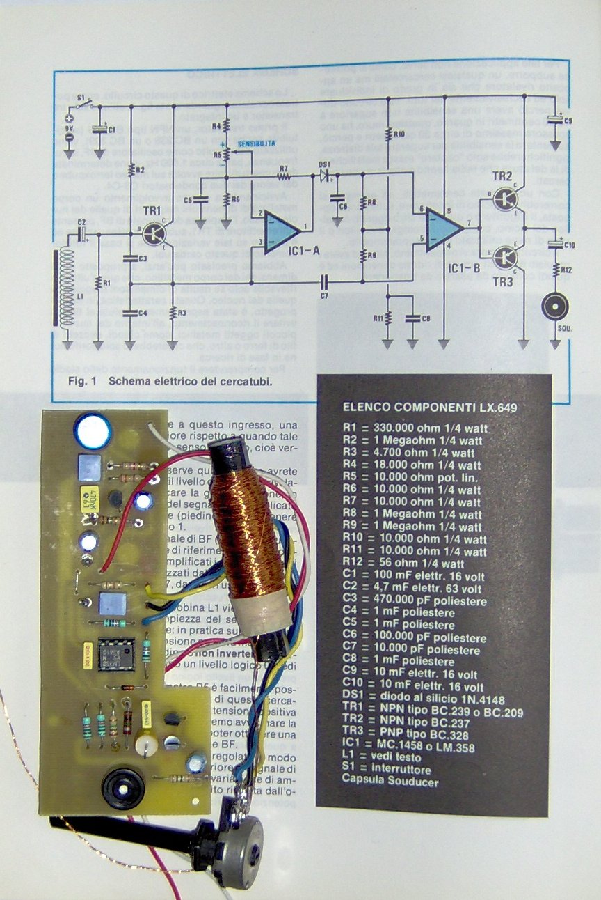

          Not tested in the field...just mounted from junk parts :
          -an lm358
          -a single transistor
          -a ferrite rod like little am radios
          -a pot
          -a small soundcer/buzzer (40ohm)
          -some 0.3 wire
          other junk like the above
          This was a "pipe" finder project on an old magazine I found on local library here (they have a lot from different countries in the archive) ,I've little modified the circuit and obtained 1 and 1/2 inch stable.
          Works at 1KHz (original was 1700Hz) and consumes only 2mA in silent mode.

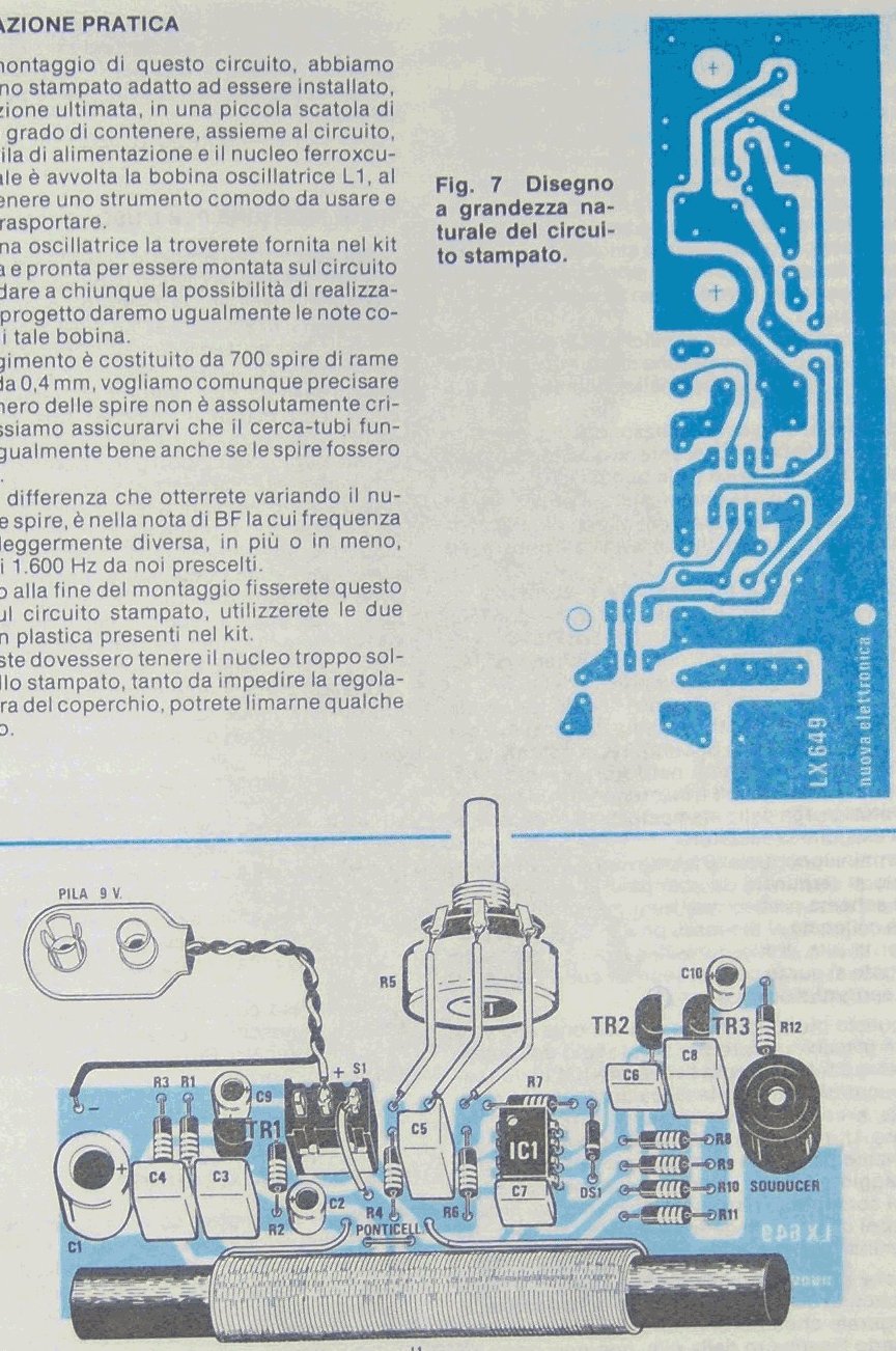

                here it is...
                Originally posted by Northerntrowel View Post
                Hello! Max and Anker.
                Normally, I use a pinpointer to know where is the coin in the hole.in the bottom or on the sides of the hole. If there is an old silver coin, I does not want to make a scratch.So! for this reason 1 or 2" is correct for the most of my hunt .
                But! WoW! Anker you have a great pinpointer!!!12cm. I thing that if somebody has to dig large holes and that it uses a large shovel then your pinpointer would be more desirable.
                Max,if you can post a drawing or a picture of your pinpointer.Maybe somebody here could interested to try it!!? Me the first!
                Thanks!
                JF
                don't know if there is some copyright about till now, maybe I've first to post to Carl before
                I put something from magazines/other pubblications here... to first require some authorization
                from the magazine/owner(s) (an italian magazine in this case).
                Anyway, it's a very old circuit maybe from 1983 (maybe copyright expired ?) or so and
                this is what about original and modified circuit.
                Original purpose was a "in wall" pipe finder.
                Original coil is 0.4 mm diameter magnet wire, 700 turns on ferrite rod, giving a freq.
                of about 1700 Hz in the circuit.
                One could use anything for T2, T3 just common pnp and npn types.
                T1 is just a bit sensible and must be some good gain (say 200HFE min) npn.
                Just one transistor in osc stage - very simple.
                Tested old c51xx (unknown npn) and works, I found in the old am radio too.
                I've modified the circuit this way:
                - used a shorter ferrite rod found in same small old am radio
                - wounded 1000 turns with 0.25mm wire and another with 0.3mm wire --> second works better
                - something from 700 to say 1200 turns would be ok and wire from 0.2 to 0.5 too
                - used a 22Kohm lin pot instead of 10Kohm --> if can't stop sounding use bigger value (47K, 50K, etc)
                - used 470nF for C8 instead of 1uF
                Circuit is very easy to operate. Just switch on and set a threshold on the pot...then
                can detect easy 1 eur coin (loud) at 3.5cm.
                It's not a Vibraprobe but seems working...and costs nothing !Only a 9volt battery required.
                I think also depth could be improved a bit also. I have to enclose in something and try on test field search.
                Best regards,
                Max

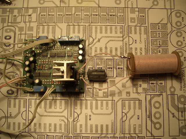

                    guys, I ask you to remember that you have VERY much famous pinpointer worldwide (your pride) because you are HERE. HERE is site of Carl Moreland. I re-present it for you - Hammerhead-PP

                              have tested in my garden the "poor-man's" unit...seems it works. Used graphite shielded pipe to enclose this time. Seems no problems with static charges and capacitive.
                              In ground:
                              Detect easy at 1 - 1.5 inches detpth 1 and 2 eur coins. Not easy small pieces of metals like nails fragments or small oxided iron wire pieces.
                              Have to test in real search !
                              Best regards,
