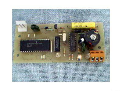

                          I have been Searching for a couple of days now for any Schematics. The only thing I came up with was this photo , a simple PCB Board of a Vehicle loop Detector. No Schematics yet , sorry . Eugene
