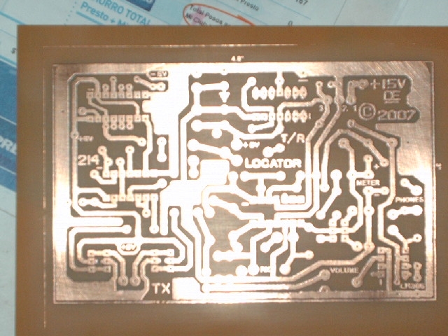

    Hi, here is a link that show us another way to make good pcb´s at a very low cost.
    http://www.pbase.com/sinoline/pcb_experiments
    Also i m showing my TR locator pcb made by this way
    Nelson

      Hi Geo.
      I used laser printer, with couche paper number 90 to 120 is ok. Dont use photo paper, is expensive and have for me no good results. This paper is normaly used on good presentation magazines cover. Then i iron the picture on the pcb.
      After that i apply quemicals. Time is around 5 to 15 minutes with very good results.

          PCB etching
          Sorry but i insist, use couche paper that is low cost.
          Max, try to use less acid. Time will be more, about 5 to 15 minutes, but results are excellent. On my pcb´s i also got the very small text printed on it.
