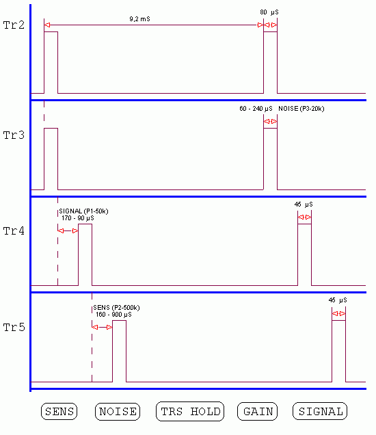

                  Now on deltapulse and PIs witth double pulses:
                  after tx switchoff you have always a delay I call "the first delay" that cold be from some few uS (5-10) to some hundred of uS (usually never more than 200us).
                  First: original deltapulse was designed for deeper search on big items using large 1mtx1mt coil...so maybe you need tune it to your needs and you do so modifing coil and timings.
                  For delta diagrams (original):
                  tr2 is signal for gate of mosfet that is tx period 9.2mS nothing, then a pulse of 80uS.
                  tr4 "signal" show you first delay (90-170uS) and sample window (45uS).
                  tr5 show you second sample (equals to first = 45uS) and inter-delay means delay between the two samples (160-900uS).
                  WHY THIS TWO SAMPLES: simplifing... a differential integrator is used to cancel out low noise from signal path and also to minimize drift related to components warming...that is very slow...but could be a problem in mono-sample designs. Double sampling/diff integrator cancel noise cause noise is everytime present with similar level and then subtraction cancel it due to double sampling-diff integration and useful signal is still present there.
                  Another important thing is that after say 100us or more useful signal vanished and remains only noise ! So if diff-integrator subtract these two samples (first and second) noise is virtually cancelled out.
                  You can find more deep explaination on hammerhead article and on many other sources also in this forum (there is a good article of Reg Sniff but I can't remember where I saw last time).
