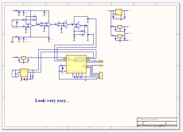

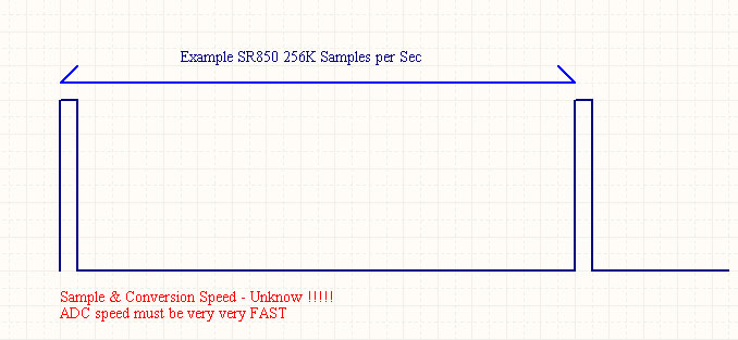

      • #63
        Originally posted by TheWizard View Post
        upper picture
        Not ADC,
        Sample must very very fast for low error....

                • #68
                  Exponential Moving Average,
                  Integrator //y[n] = a * y[n-1] + x[n]
                  Create Audio Tone.....
                  • #69
                    DSP Part....
                    • #70
