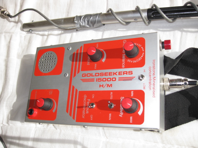

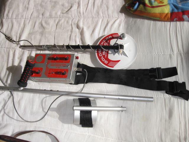

                        GOLDSEEKERS 15000 MINELAB
                        Hello to all in this thread with interest on the 15000
                        I have one and is incredible on mineralization or black iron soil
                        It was the first put out by Minelab,to compete against the big brands
                        And it has an excellent Ground balance so good that in mine
                        I have pulverized a rusty old nail and mixed it with black soil in a small glass jar.And you put that over the coil and is able to ground balance
                        it off.While going at the same time with a small 1gram gold nugget and get a nice signal.
                        Just wondering is their an update of the schematic with all the I.C numbers.I have asked Eugene recently,waiting on his reply.
                        Mine was a later model when they fixed all the bugs,and one of few made specially made for Hipmount with the small and large coil.
                        Here are the pics.Cheers
