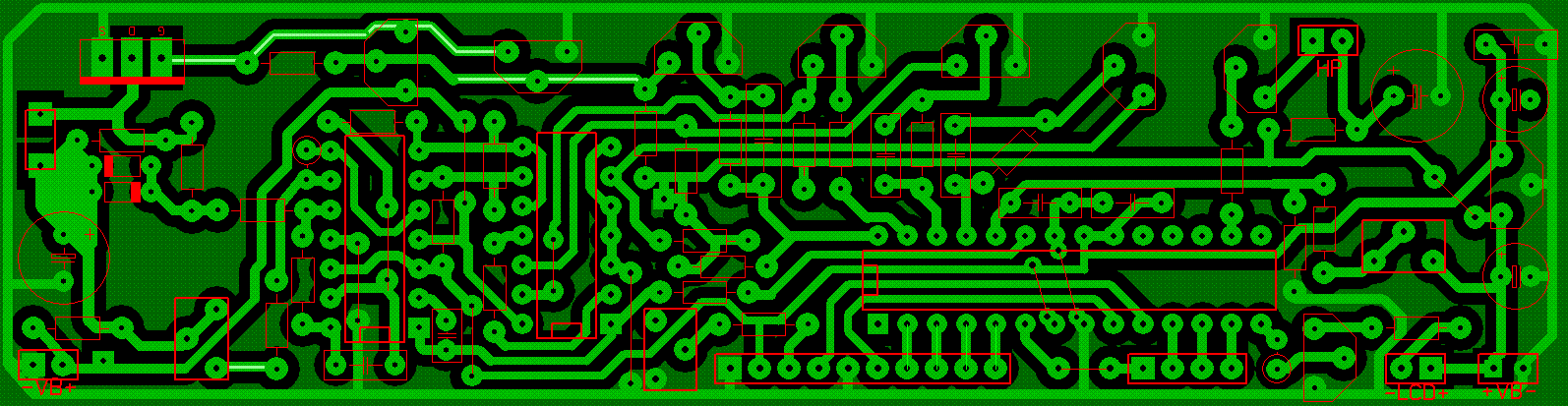

            Build a pcb like this: Click image for larger version
            I have made this that works OK.
              Nice PCB

                I searched my pc, don't found the .lay pcb file... Only there's the gif file which is posted here.

                              Build a pcb like this: [ATTACH]4151[/ATTACH]
