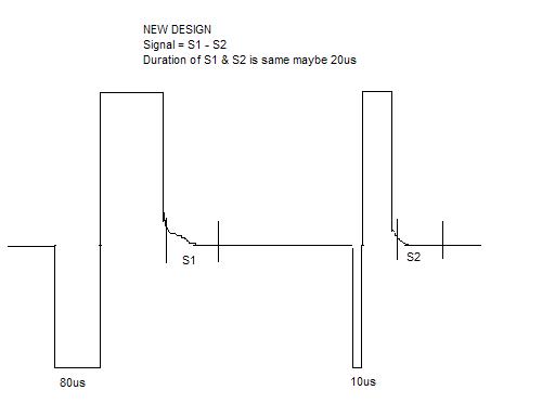

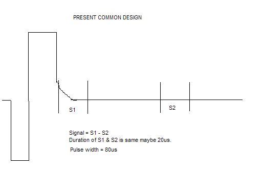

Last evening i was looking at minelab MPS (multi period sensing), where we transmit pulses of different sizes to encounter ground signal. Has anyone tried this configuration, i was planning to play with it but would be easy if someone has already used it.
Any ideas on how should i go with it. My present design as already the most common:
But with multiperiod sensing maybe we can have this kind of configuration for better groung signal balancing:
Cheers,
Michael
