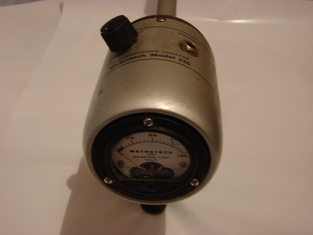

              Do you still have a MetroTech 220 detector ?

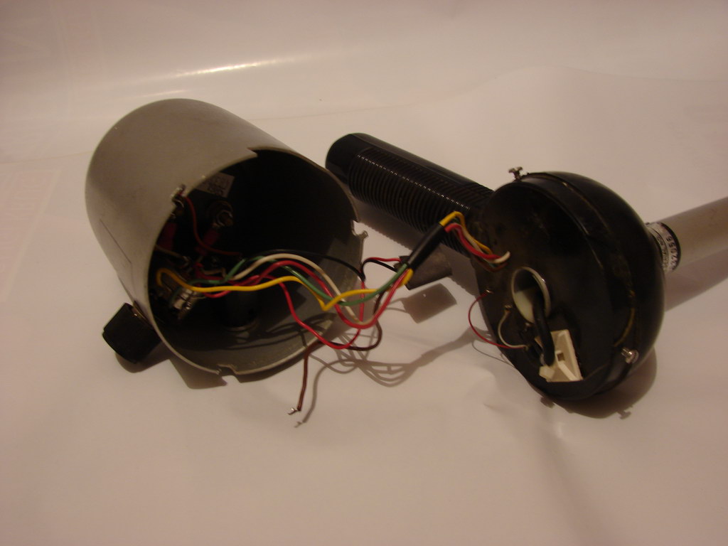

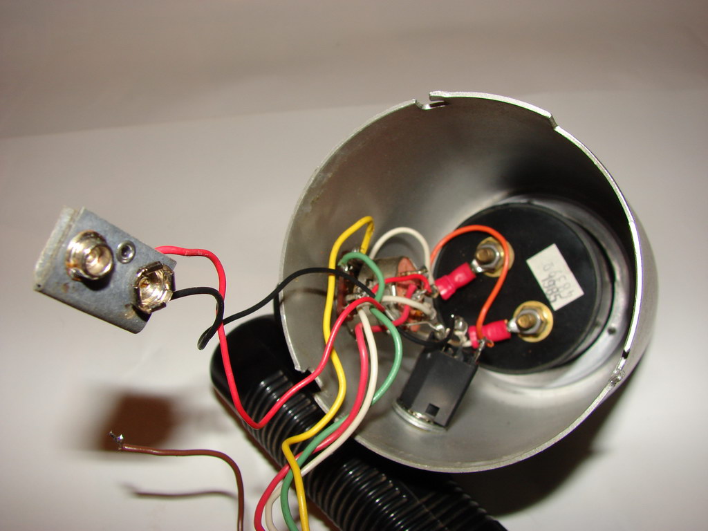

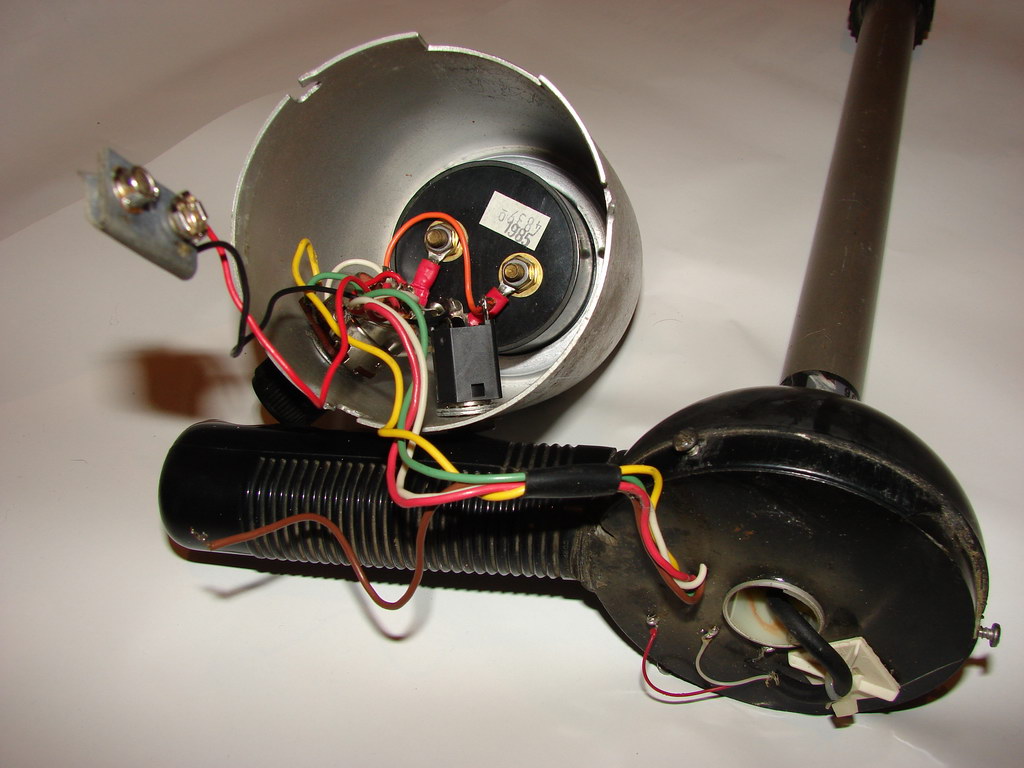

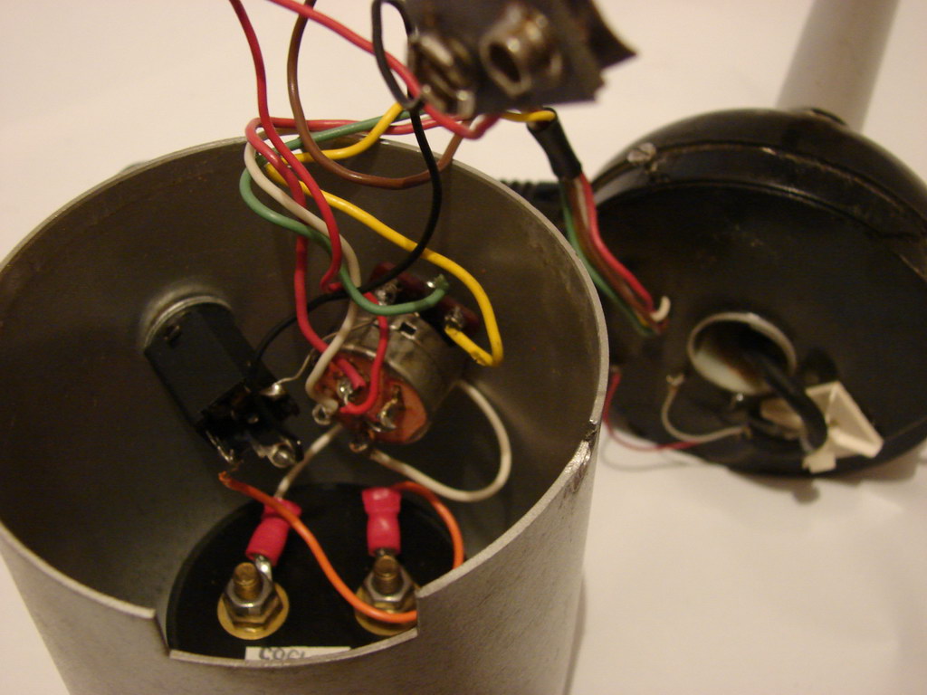

              I have a faulty one and need to place one wire to somewhere... brown wire is disconnected.
                >sdesic... Yes, I still have it. If you could include a pic that would be helpful. But I can check mine tonight and look for the brown wire and see where it's connected. Do you have an operator's manual? I'm still trying to track one down.
                  Rayman
                  I will post few pics in 15 minutes.
                  i have no manual ... sorry, if I find it I will post it here.
                  I got detector and speaker box.
                  Thank you.
                  Sinisa
                    I am posting pictures of Matrotech 220 A
                    Brown wire is loose.
                    I guess it needs to be on pot by looking at connections ...

                    Don't know how to open MD head enclosure of this type.
                      sdesic

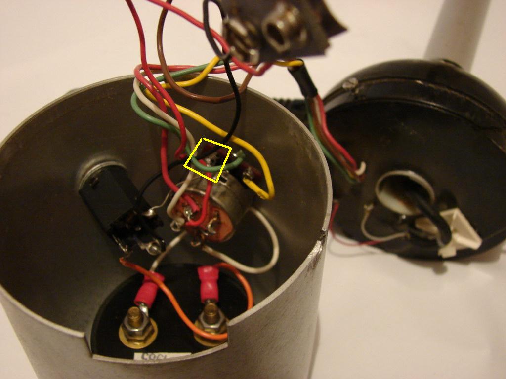

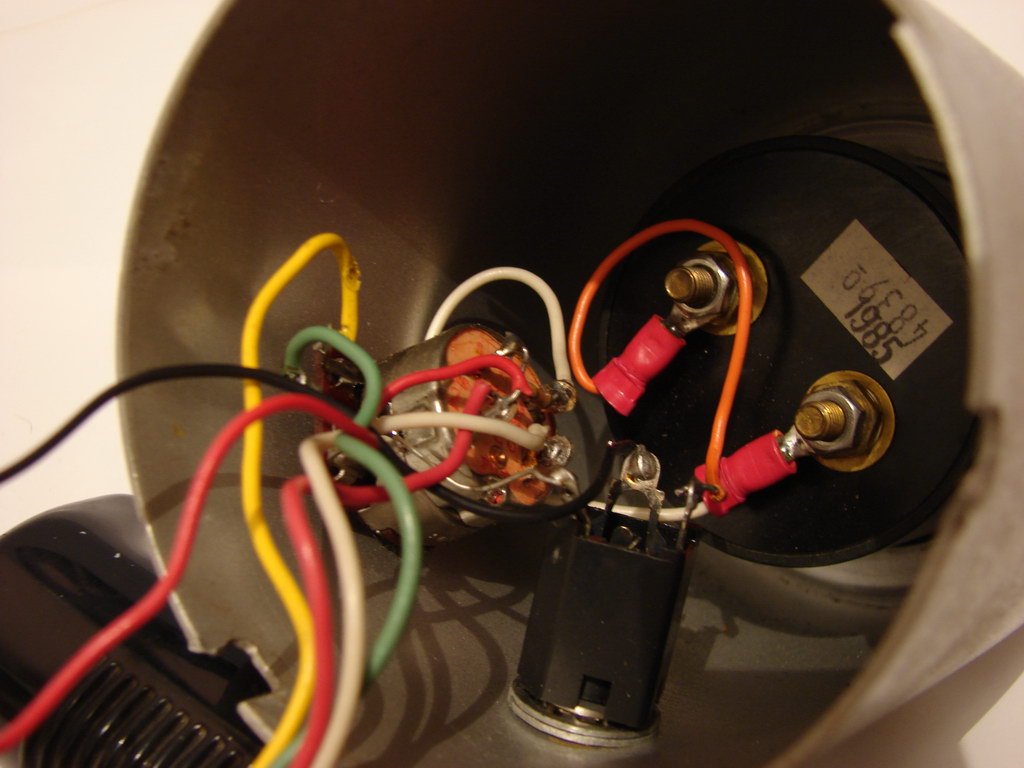

                      The brown wire connects to the potentiometer on the end tab. That same tab should also have a bare wire that connects to the headphone jack. I've attached your pic and highlighted the correct location for the wire.Click image for larger version
                        Rayman,
                        Thank you !
                        I assumed so... I will try that tonight.

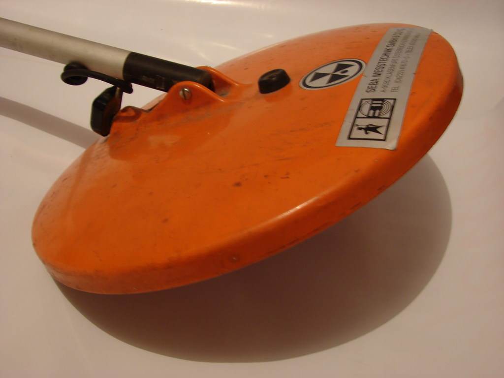

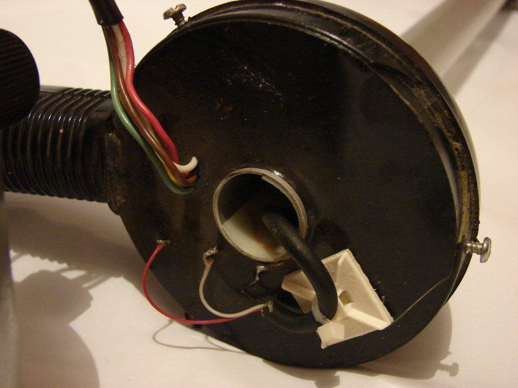

                        I have also problem in MD head - something is loose...
                          Sinisa
                          Good luck with the repair. As for the MD head, I doubt there is anything wrong with it. It is a simple inductive coil consisting of a copper wire wrapped around a non metalic form.
                          Rayman
                            I just tried it with brown wire connected ... no luck
                            Speaker box seems to be problem No. 3
                            It has some kind of electronic circuit in it but no sound from plain audio device - gives 11k6 resistance on connector.
                            Will try headphones but I think this device needs piezo headphones - or hi resistance with transformer.
                            I will try to measure resistance of coils - 1 connector - 3 pins (big stereo phones connector)
                              Tested resistance of coil - it is on two pins ... third is not connected I think
                              about 3 Ohms ... 66 uH (micro H)

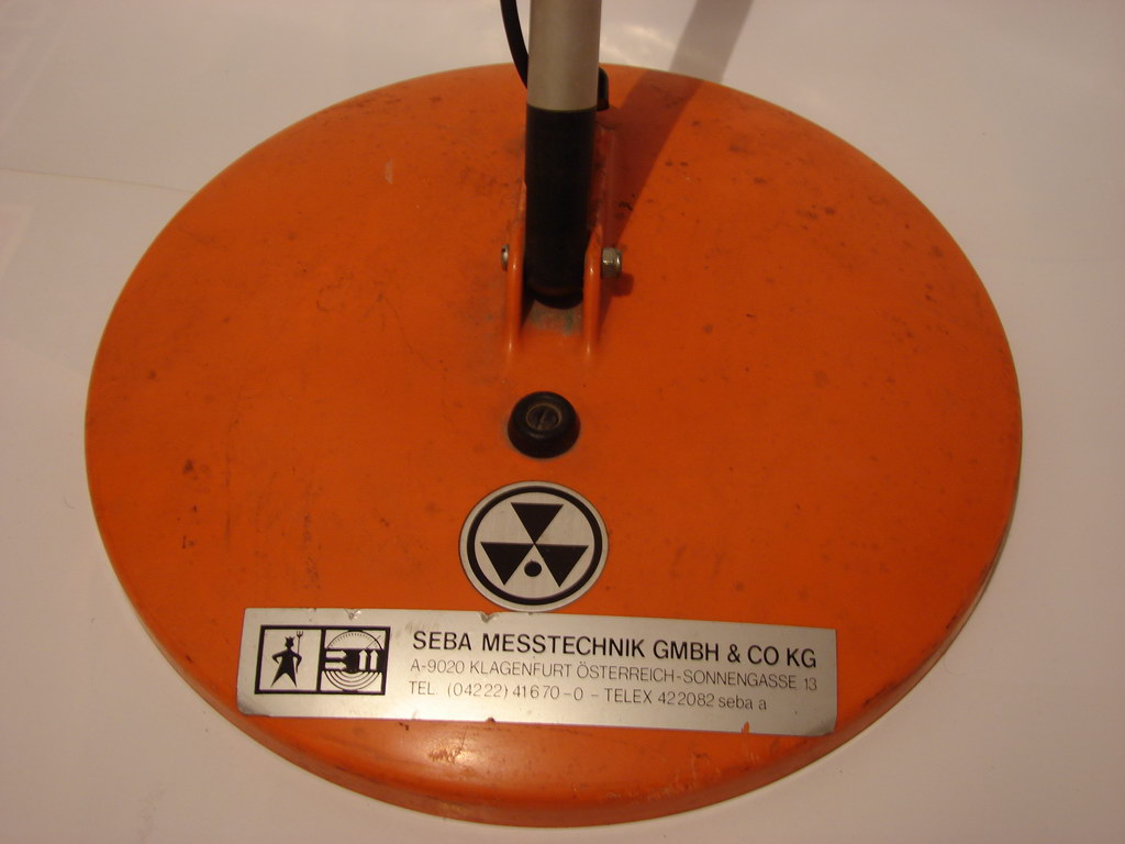

                              Opened top of detector head - by removing "radioactive" logo
                              under it it is a hole ... you can see peace of (probably) aluminium (3-4 cm long)
                              which is connected to button on top which is sensitivity button
                              (it rotates this peace of metal inside and disturbes magnetic field ...)
                              and I discovered one more loose peace of aluminium
                              which is flying around inside head...
