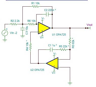

                Solution for wave falsing
                Originally posted by hobbes_lives View Post
                I'm trying to build a PI to be used specifically for hunting in the surf, and I'm curious if anyone know of a technical solution for eliminating the wave falsing that is typically experienced while using a PI in the surf?
                hobbes_lives,
                This is a subject that has intrigued me in the past. I would love to work some on the subject, using the PIC, I think we could find very good solutions.
                Here is an analog technical solution for reducing the signal created by the waves.
                The bandpass filter will attenuate the signal caused by the slow changing water column above the coil.
                For small targets it will enhance the signal. It will also reduce general noise.
                The precise parameters should be chosen according the sweep speed and coil diameter.

                    Wave action isn't periodic, it's random in both frequency and amplitude. Yes, overall it will have an average frequency and average amplitude, but the instantaneous variation is too great to make any practical predictive circuit.
                    To make matters worse, even though wave action is usually much slower than normal coil sweep speed, when you get the coil in the water you have to slow way down, so now wave action is closer to the speed of a target response. So simple filtering won't work.
                    What I do is just watch the waves and double/triple sweep when I get wave-induced responses. The other solution is turn up pulse delay and lose smaller gold.
