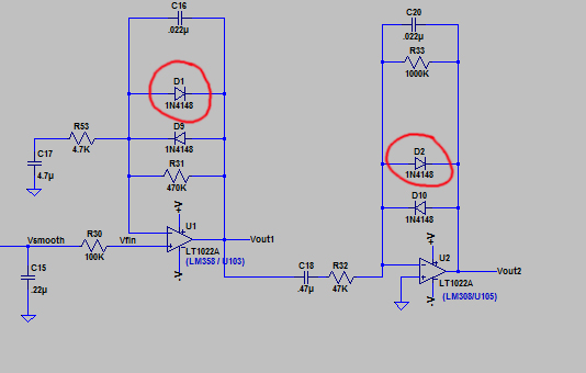

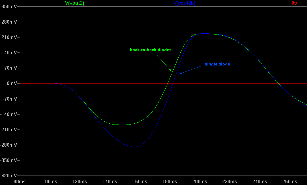

  • parallel reverse diodes - better???
    I tried adding another diode in reverse direction in the TGSL amplifier op amp section. The idea is to limit the negative going pulse in addition to limiting the positive pulse. The purpose was to perhaps improve the response a little if possible.
    A simulation suggests that this might slightly improve the response, but not by much.
    Just another tweak.
    -SB

        • I tried your double diode to reduce the crash time into the -ve rail... I see what your trying to do..
          I used a diode with a lower turn on voltage - so the problem doesnt get so big - before you try to correct.
          Yes I have the diode the other way - so you get a real solid +ve ID, almost no negative crash and so no dead time after a hit.
          This is with a 100uF in there so we get 2 benefits - gain where we want it and no emarrassing 3 second recovery dead time.
          I may try this as it looks promising.
          S

            Interesting. In my sim I tried a schottky diode for the added diode, and it seemed to ruin the action somehow. I thought perhaps it didn't allow enough lower initial swing. I'm thinking maybe we need a symmetrical swing at least or maybe we could lose a little depth in some cases??? I don't know, I'll be interested in your findings.
            -SB

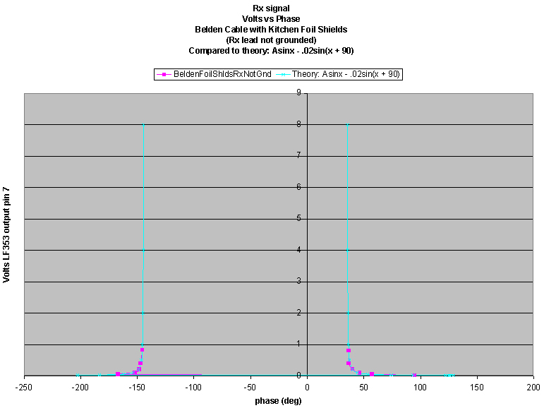

                  • nulling, foil shields, belden cable, theory
                    Still pounding this experiment with null voltage vs phase into the dust...
                    Latest experiment surprised me, as the results looked radically different from the previous.
                    This time I tried a Belden 8723 cable with kitchen foil shields...
                    The nulling voltage vs phase curve was "inverted", meaning the phase moved in the opposite direction as I moved through the null point.
                    To try to understand what this meant, I tried the theory that the null voltage was comprised of two components as follows:
                    Asinx - .02sin(x + 90)
                    where A is varied from 8 volts to -8 volts as the coils pass through the null point.
                    The results seemed to match quite well the experimental data. The difference between this theory and the previous one matching the other data was simply the sign of the constant component "- .02sin(x + 90)", being negative in this case and positive in the previous cases.
                    This suggests that with the foil shields and Belden 8723 cable, there is a "non-magnetic" component that is still in quadrature with the Tx signal but 180 degrees different than the other cases.
                    Not sure what this means if anything. Perhaps the foil creates a small quadrature coupled signal that only shows up with the Belden 8723 cable, and it is overwhelmed by a larger quadrature signal that is opposite sign (180 deg phase) when the USB cable is used.
                    Well, having fun...
                    -SB
                    • Simon, I have only seen similar to this when I accidently reversed one coil to the other.......
                      Andy

                        Simon ,
                        I've noticed same behaviour before watching the output of LF353 vs Tx , comparing the USB and Belden 8723
                        At first I tought I reversed the leads but I had no double beeps , still reversed the leads resulting in double beeps ,so I was right in the first case.
                        I'll get back on this thing.
                        My ordered connectors have arrived so I can finish my 2 new cables : new usb cable and a 4 wire cable with each wire seperatly shielded ( braided ) all together with a twist .
                        kind regards ,
                        Dennis the Mennis

                          Ok, interesting. I'm pretty sure my coils are not backward, in answer to der_fisherman's good observation (but I'd better check again). Especially because with the USB cable the phase moves the other way.
                          So something happens differently depending on the cable. I'm thinking maybe there are two basic sources of capacitive cross-talk -- shields and cables. And the Belden cable has such small cross-talk that the shield cross-talk, which is opposite polarity, is able to dominate. But that's just a convenient model for now.
                          So we'll see what new things you find.
                          Cheers,
                          -SB
