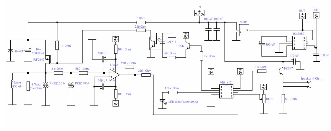

                      Last week I started to learning AVR assembler.
                      For training I am using the simplest detector with microcontroller, BT1 from böses Tier.
                      This is original assembler code

                      Now I am using mikroC for AVR
                      Code:
                      const int PulsDauer    = 4;    // 1..20 ca 10..200 yS
                      const int HalbZyklus = 80;  // Gesamtzyklus ca 1,7 mS 2 mal 80+ yS
                      const int Delay1 = 5;       // Sample-Delay 1 nach Pulsende 3-15
                      const int Delay2 = 8;       // Sample-Delay 2 nach Delay 1

                        This is machine translation from German document:
                        The Pulsdetektor BT-1 (BT stands for evil animal GRINS * *) is for two reasons
                        emerged. First, from the intense preoccupation with the possibilities
                        The fully digital signal processing with AVR processors and the other from the
                        Pulsdetektoren idea into a robust body with standard tube
                        Diameter (eg 40mm KG pipe from the hardware store) for subscription. The installation
                        in a tube is, moreover, for the construction of an underwater detector very
                        useful ;-) This circuit was actually only for experimental purposes
                        but thought I liked so much that it I've built a detector. Planned
                        is the part of me first as a hand digging around the detector and the
                        Digging holes to browse, because this task for a large detector
                        unwieldy, and a large coil for positioning the Fund to play imprecise
                        is. For this task, I have even a rudimentary metal differentiation (LED)
                        installed.
                        The component cost and the size should be limited. That
                        was achieved by the abandonment of the tone and the difference amplifier
                        by the processor over. As the processor was chosen ATtiny12
                        because it has the necessary Comperator a small design (8Pin DIP) and a
                        internal clock, and hence the circuitry required for the
                        Processor clock lapses. In addition, should do everything as cheaply as possible
                        fail? and obtainable at a vendor's (hence also a IRF9640
                        as the MTP is not so good is available).
                        At this point I would like to refer explicitly to www.pulsdetektor.de, there
                        lurks the contagious virus detector. And I have Silent Water and Chris thank.
                        Without the two, I would have a bloody amateur must throw in the towel. If
                        in this document contains errors (which is quite likely), please use this
                        pulsdetektor.de in the forum of discussion.

                        Functioning
                        Amplifier
                        OPV
                        Drivers
                        Processor
                        Drivers
                        In Pulsdetektor BT-1 is the control of one of the ATtiny12 microcontroller
                        Atmel company over. The whole timing can be adjusted in the program
                        are (pulse duration, HalbZyklus, Delay1, Delay2). The processor generates a
                        Distance of approximately 1.7 - 3.5 mS (2xHalbZyklus + Pulse + Delay1 + Delay2) a
                        Pulse 10 to 200 yS width (pulse duration = 1 .20). The pulse is located on PB3
                        (PIN2 ATtiny12) and is controlled via a driver stage (BC547, CNY17) to the
                        Power transistor IRF9640 given. The driver stage is necessary because the
                        Outputs of the ATtiny12 with max 3mA (active HI) may be charged. The output
                        transistor switches the primary of the pulse from a 4700 to 10,000 YF Elko
                        is fed. The coil creating a electromagnetic pulse. After
                        the disconnection of the pulse occurring secondary signal (for metal coils in close
                        changed the course of the falling edge) is taken from the operational amplifiers
                        (LF357) and reinforces the Comperatoreingang PB1 (PIN6 ATtiny12) of
                        Microcontroller where. The Comperator works continuously and compares the
                        Tension between PB0 and PB1 (PIN5 / 6 ATtiny12). The reference voltage is
                        on the switch with potentiometer (voltage divider on the mass and +5 V, Abgreifpunkt to
                        PIN5) led to PB0. The evaluation of the software is Comperators
                        a break (Delay1) performed. If this Austastzeitpunkt to send a signal to
                        PB1 on the reference voltage at PB0, an impulse to the Speaker (PB2)
                        where. The speaker is powered by a transistor (BC547) driven. After a
                        another break (Delay2), the Comperatorstatus re queried. If the level
                        PB1 to still greater than the reference voltage at PB0, is a very broad
                        Secondary signal as it is only in the case of iron or very large objects occurs, and the
                        Speaker pulse is extended to a different sound to produce then the LED
                        switched on. See the pictures from Oszi. So you can on the LED and
                        the tone of size or metal close. The LED, it is with
                        high probability of iron or a huge lump of gold ;-)

                        Comperators. Red by the operational amplifiers processed signal.
                        Waveform with a small screwdriver (iron) and a larger
                        Brass object.
                        Apparently, the shortening of the sample 1, a delay path to higher
                        Sensitivity but also a shift in the critical area of steep
                        falling curve which is practically not so good results. The timing is in
                        each concrete case to the coil (inductance) and the supply voltage (7-15V)
                        adapt. The brutal Improve the supply voltage to 15V brings less
                        as too is suspect. With a 9V block just to get good results in
                        less space and weight.
                        The Halbzykluszeit the main loop can be changed. It is
                        However, please note that the change in the throughput of a main loop
                        Tonveränderung means.
                        For the driver stage (BC547 max. 100mA load) of the Speakers (8Ohm) where
                        Using a headphone (32Ohm) of 50 ohms resistance at 22 ohms
                        reduced.
                        The power supply may not be less than 7V is because otherwise the voltage
                        78L05 no longer clean 5V power supplies.
                        Special circuitry technical measures for a trouble-free Power On
                        Reset to ensure that are not necessary since the ATtiny12 on a delayed
                        Power On Reset cycle.
                        Handling
                        At startup must be no metal in the search of his coil. On Poti with
                        Switch and turn the knob fully. Then the pot slowly
                        back to regulate LED and speaker are all (here is the art of the most sensitive
                        Area to meet). Ready!
                        Typical behavior:
                        When you find metal speaks first to the Speaker. When iron shortly thereafter, when
                        further approximation, the LED and the tone is changing. At
                        Non-ferrous metals, the LED does not speak or only much later.
                        Very small or very large objects:
                        For very large objects also speaks to the LED. Over the whole
                        Annäherungsweg is but one more time, switching the LED on iron and
                        Connect a rather late to include precious metals.
                        For very small ferrous objects can also be from the LED will remain is the
                        But slow beep when removing the coil quickly away again.
