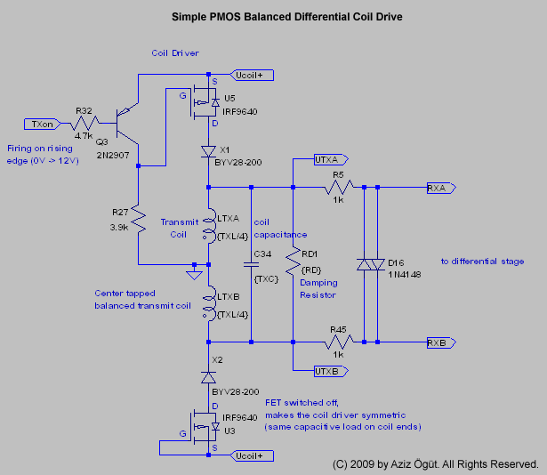

    • Hi all,
      here is, what I mean. If you don't use the bipolar transmit pulses (alternating coil current), one can even balance the coil driver with a second switched-off FET stage (see below). The capacitive load of the coil ends to ground should be almost same. The FET below may also avalanche. It adds some capacitive load into the coil.
      The differential stage will "kick" the target stronger compared to single ended design.
      Aziz
      • If you don't use bipolar transmit pulses and second switched-off FET stage, just add a high voltage adjustable capacitor parallel to the below coil half to achive capacitive load balance. Below part can then be omitted.
        But the symmetrical FET stage has a better CMRR and PSRR. If the coil driver is made for true bipolar transmit pulses (totally symmetric coil driver), this should have the best performance. It will also degauss the ground!!!

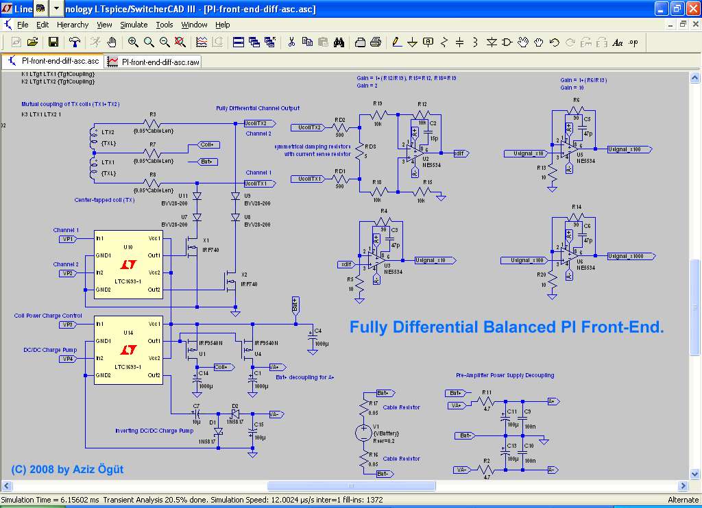

              • for reference to the current discussion ... credit to Aziz ....
                ... http://goldprospecting.invisionplus....l=differential
                ... and repost because I think Aziz lost the original ...

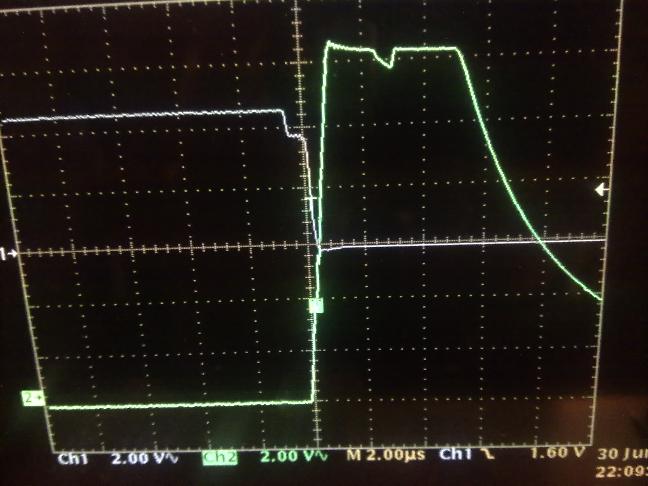

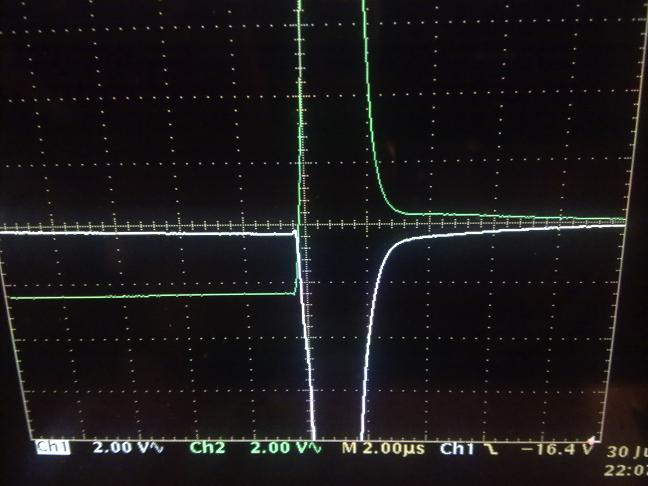

                • Hi all ... here are bench results for v600a schematic ..
                  PIC 1 balanced flybacks at either end of coil.
                  PIC 2 o/p from diff amp ( green ) vs MOSFET gate drive ( white )

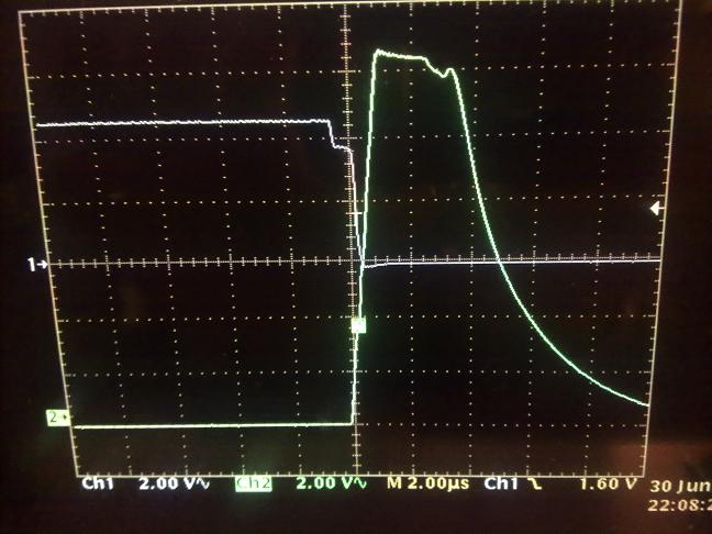

                  PIC 3 o/p from diff amp ( green ) with target vs MOSFET gate drive ( white )
                  As you can see you dont need fancy bipolar flux capacitors to get good results. In fact the balance circuit consists of two 10K resistors.

                    • Hi Paul,
                      thanks. Indeed, I lost this picture and the corresponding spice model. Anyway. The picture shows the conventional difference amplifier with low input impedance. There is an inherent attenuator, which allows early sampling.
                      A true instrumentation amplifier design should increase the input impedance without attenuating the signal.
                      The idea behind making the coil driver symmetric is the following: The leakage current through the FET and drain diode will be compensated (eliminating offset voltage). Any temperature dependency of this too. Particularly both parts have high temperature behavior.
                      Alternating pulses will produce less heat on the parts too.
                      Balancing is quite trivial and can be made with different solutions.
                      In the coming days, I will order the mentioned inst. amps.
