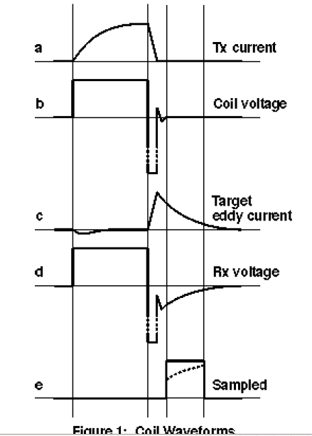

      • Gday Guys,
        There's one thing i think we all agree on & that is there is a lot of differing opinions, idea's etc to as exactly what is what & how this works & how that doesn't. Or like mentioned by Simon before what means something to one person may have a different meaning to another so confusion rules.
        On the other hand we would not have any idea who is posting some of the information in these threads & if it is just mileading or not?
        As an example robby_h could be rob the project manager of minelab for all we know, he sure writes like he does. Or Zed could be the man himself--we just don't know & or about the information given, if it's correct or misleading?
        So how about we do get on the same page as each other & then we can come to our own conclusions.
        I have attached a very simple chart, if someone like the fence sitter Carl--nudge, or any of the other fence sitters would like to add to the chart & include all the relevant Ti's?, Td's?, Xy'?s & Zed'?s everybody then can relate to what were talking about & we have at least a basic layout to compare things.
        If we test then we can add to the basic chart to show exact points at which we are testing & or trying to test etc.
        See what you think but we have to have some sort of a basic standard to give relevant information to each other about what were trying to do & it is a visual example for everybody. There is a language barrier to consider as well so basic charts are the way to go to help people.
        Don't know about you but i can do with all the help i can get, at the moment it seems we are just off on our own little trips each in different directions.
        Of course if anybody wants to improve the chart then go for it, but lets achieve something hey?
        • Yes, i forgot the bloody attachment--DUH!!

            • Simon,
              The ground X signal is only present during transmission so it obviously can't be present during a period of non-transmission regardless of what unregistered Doug says in post #131.
              We could though use an example from his forum where they claim to sample earlier than Minelab by using a balanced coil even though they don't do anything to make this possible.
              They claim to be able to sample at 11usecs when using a mono and have all GB samples out of the way 15usecs after switch off when using a balanced coil.
              At the time they made this claim their sampling routine occupied 12usecs (2usec on, 2 off, 2 on, ~4 off, 2 on), so it would appear their first sample commenced at around 3usecs.
              This means they would be sampling the spike in their first and second samples and sampling the true off period in their last sample.

              Tinkerer,
              Enough of the vast knowledge bit. I wish!
              I'm only interested in clearing up the simple basics. If we don’t then it just ends up a confusing mess.
              I mentioned Dave Emery's patent because he uses a pi type pulse to generate a large back emf at switch off then causes this to ring with a cappy, something we avoid in pi. He then samples the resulting oscillations similar to vlf (IB) so this is actually a high powered vlf and not pi.
              You do much the same but sample the spike itself so it is high powered IB or TR.
              B^C,
              I for one agree that your chart accurately depicts pi when looking at an ideal target provided the tx coil's spike has settled for a suitable period before sampling begins when using a mono or balanced coil.
