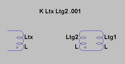

                          To me it is confusing to think in terms of separate magnetic fields (although your analogy may be perfectly useful). I just see a magnetic field that was growing and leveled off and then suddenly starts shrinking. Just a continual change. The target sees varying dphi/dt, which it responds to accordingly. And I agree the dphi/dt changes direction at discharge because di/dt changes direction -- even though the current is still going in the same direction through the TX coil. So the current in the target I assume changes direction too.
                          So I'm quibbling over description there -- more importantly, maybe there is something to your observations we could explain and make use of:
                          Suppose we can create a more powerful target "response" (measured by our RX coil) by actually reversing the current in the target rather than just stimulating it in one direction.
                          As Carl explained - maximum target-stimulation from the TX turn-on happens at t=0. As you let the field build up, it slows down in rate and so your target current dwindles too -- but you get a nice fat magnetic field ready for the big turn-off pulse.
                          But is there a possible trade-off? What if we turn off the current while the TX is still building fairly fast? Could we get a bigger (or longer) di/dt in the target, and thus more pulse in our RX coil?

                            A question about the above statement -- if you model a target as two separate inductances in series , only one of which is coupled to the magnetic field (not saying this is real), then it would seem you could "charge" the target, because even a small dphi/dt would "integrate" in the second inductor. Is it possible that eddy currents could do something like that?

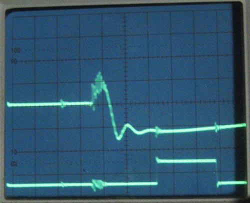

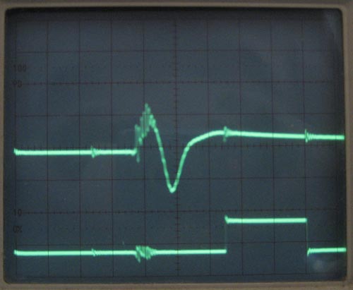

                                I will add one more piece of the puzzle. I re-post two scope pictures from the coil thread, for the other pictures please go to that thread.
                                The TX is about 42uS. The coil TC is about 116uS.
                                Now look closely at the end of the TX pulse at the right. The coil current is at about 1.3A. The gain is 40.
                                Look at its position at the 0V line with no target.
                                See how it goes down or negative with the silver coin at the coil.
                                See how it goes positive with the ferrite.
                                The top trace is set at 1V div. and 1uS div.
                                The bottom trace shows the sample pulse and is set at 5V div. and 1uS div.
                                For the ON time sample this is the point of the highest signal amplitude.
                                The highest amplitude is at the time of the highest coil current when the TX pulse is up to one TC.
                                When I add a resistor in series with the coil, to shorten the coil TC, the highest signal amplitude is at about 1 coil TC.
                                But, the highest signal amplitude changes in time with the TC of the target.
                                I have noticed that the time of highest signal amplitude is also influenced by the capacitor that I add in the feedback of the preamp.
                                So it is a puzzle of many pieces. How does it all fit together?
