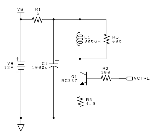

    Here is what I meant... normally we run R3=0 and the current is limited by the supply voltage divided by all the series resistances. With R3 (called a degeneration resistor) Q1 acts like a voltage-controlled current source. If VCTRL comes from a regulated source then the current does not vary as the battery drains.
    Furthermore, you can 'shape' VCTRL during turn-on to get different effects. Bring it up with a pulse, ramp, or exponential. You might see some interesting effects. Mind the heat, though.
    - Carl
      hi carl,
      i understand, I=(vctrl-vbe)/R3
      you are right Q1 may be hot
      olivier

            Originally posted by o.mag View Post
            hi carl,
            olivier
            that's for sure... if the difference is high the transistor will get a lot of heat to sink...
            But infinite gain ?
            That's pretty easy calculation (if we don't consider minor issues) : suppose you have 3A as current I=3 , then you need Vctrl = 13.5V
            so... 3=(13.5-0.6)/4.3=3 ... ok...
            that means also you have Vr3= 4.3*3=12.9V Vbe=0.6V then the current flowing in R1 will be Ir1= (13.5-0.6-12.9)/100 = 0
            No... it's a small current of some milliamps : bc337 has dc current gain typ from 160 to 320... then can say we have something 9.4mA to 18.75mA depending on transistor... but nevermind!
            Suppose the gain is 300... we have 10mA Ib , and Vr1=1V (much more realistic) means Vctrl will be instead 14.5V but change few I think... what's important is that you get 3A from a BC337!
            The BC337 is a bad choice... can give you 500mA at limit...(some are rated 800mA in datasheet but don't trust them, my advice) then melt down! with big smoke!
            No good there...I would use , instead, some array of good old 2N3055 with sized current driver required... or will use (much better) a mosfet as electronic rheostat (much less heat there).
            The transistors aren't that good for current regulation in the several amp range... unless you use dedicated ones or arrays of them with appropriate fault safe network (cause they will never share exactly the same current... and one can burn easy with a cascade effect).
            PS: typically VCEsat is in the 0.7V range... means you have about 0.7V*3A= 2.1W over the juntion! with 625mW absolute maximum rating... so like said above you are at 3 times the power it can run without damages! BIG SMOKE!

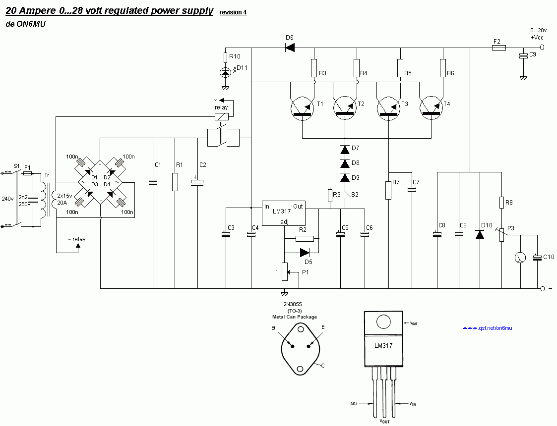

                      the current required depends on dc gain of pass transistor, in our case it's 2N3055, that has typ gain of 70. If you use many 2N3055 to share the load current you'll must polarize each base accordingly and then figure out the drive current for each of them.
                      E.g. suppose you need 3A at output and use 3 * 2N3055 to carry each 1A, then you know each transistor have IC=1A and gain A=70 so you'll need IB=IC/A=1/70=0.014 A or 14mA
                      If you need something specific I can make calculations... but I think you could like the schematic below....
                      Uses LM317 as driver for transistor bases... you have both can use LM317 as regulator and 2N3055 as pass... now you see 4 of 2N3055 but you need just a couple or 3 I think... you can scale it as you need!
                      Component bill is at : http://www.elecfree.com/circuit/powe...17-and-2n3055/
                      Kind regards,
                      Max

                          Thanks for the circuit, Max
                          All the best
                          Tinkerer
                              I clipped this circuit from a PI probe I designed. It is running only 50mA of 'on' current. For a high-power detector, you obviously need something like a 3055.
                              With heat, keep in mind that we are dealing with time-averaged power and a short duty cycle. Still, you could easily see a watt both on Q1 and R3.
                              - Carl
