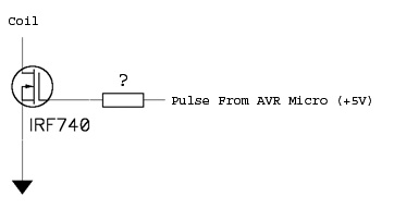

    For drive Tx pulse in a PI metal detector, we can connect AVR Micro pin directly to a mosfet for example IRF740 like this picture ? or we must
    use a resistor ? what value is nice ?
    What is the best way to drive a mosfet in PI MD?
    What is the advantage of Mosfet driver ICs ?
    thanks.... vistac2000

      you can... but it's not so elegant solution.
      The driver circuits are to provide sharp driving pulse edges and fast commutation. You can make discrete or using dedicated ICs made just for that... driving mosfets. Often driver IC will provide also some kind of separation from e.g. driving logic... that's anotehr interesting issue.

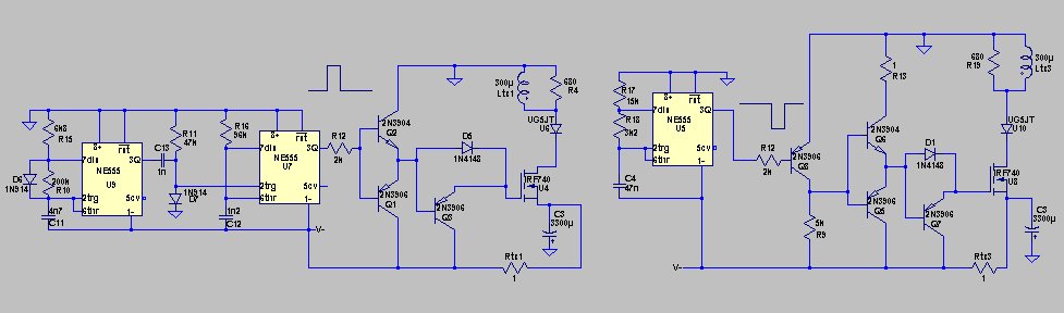

          The circuits below are a variation on some from Aziz. I think BS170 and BS250 were pre-drivers in the original circuits but BJTs (2N3904, 2N3906) are also good.
          LM555 drives a MOSFET pretty well all by itself, but if you use a cmos version then these circuits would probably help with a snappy turn-off.
          You will get faster response with one of the mosfet driver ICs but these discrete circuits work OK.
            Q3/D5 are not necessary... just use a Darlington for Q1. Done right, this is a blazing fast driver. My coil switch MOSFET is actually running cool to the touch when driving several amps of pulsed current.

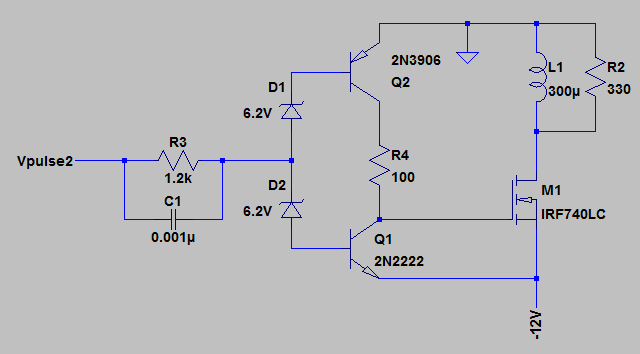

                Here's a MOSFET driver circuit that looks good in spice, turns off quite fast, but hasn't been built and tested yet. Use it at your own risk.
