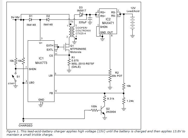

    There was another circuit i read about & i have attached the circuit, they were charging 12v Lead Acid Batties with it, they use a transformer in the schematic. I haven't tried the circuit so i wouldn't know if it works or not but apparently it does, it may give some idea's.

        Hey, could be a useful reference anyway for approaches.
        My guess is that the hard part is recovering the energy while still minimizing the pulse duration -- two goals that may be hard to achieve at the same time.
        Maybe doable with a clever circuit...
