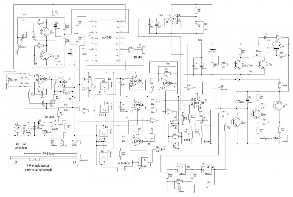

            Hi Vistac2000
            Another 2 boxes posted here is made for Sascho from Bulgaria.
            You can ask in this thread:
            http://www.geotech1.com/forums/showthread.php?t=12693
            Coils are rectangular 33X27 cm each box, wire 0.30-0.31, 100 turns. Distance between 2 boxes is 75-95 cm, this is important calculate the better distance.
            Author (member of this forum) of this device maybe know his capabilities.
            Esteban

                Hi Esteban,
                Thanks for your shared schematic,
                can you post High resolution Of this T/R schematic, and it's PCB...
                Are you build this?
                  Originally posted by vistac2000 View Post
                  Hi Esteban,
                  Are you build this?
                  No better resolution I have, but you can amplify with magnifier tool or scroll of mouse + control. I don't build it, but I suggest you ask in the properly thread.
