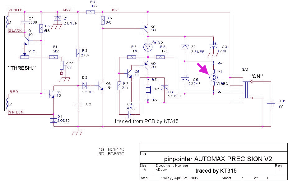

      interesting planar type coil on pinpointer... i see there... may be the info will give a direction in your search...

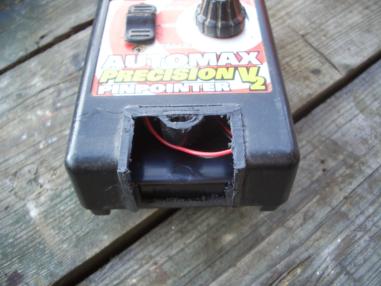

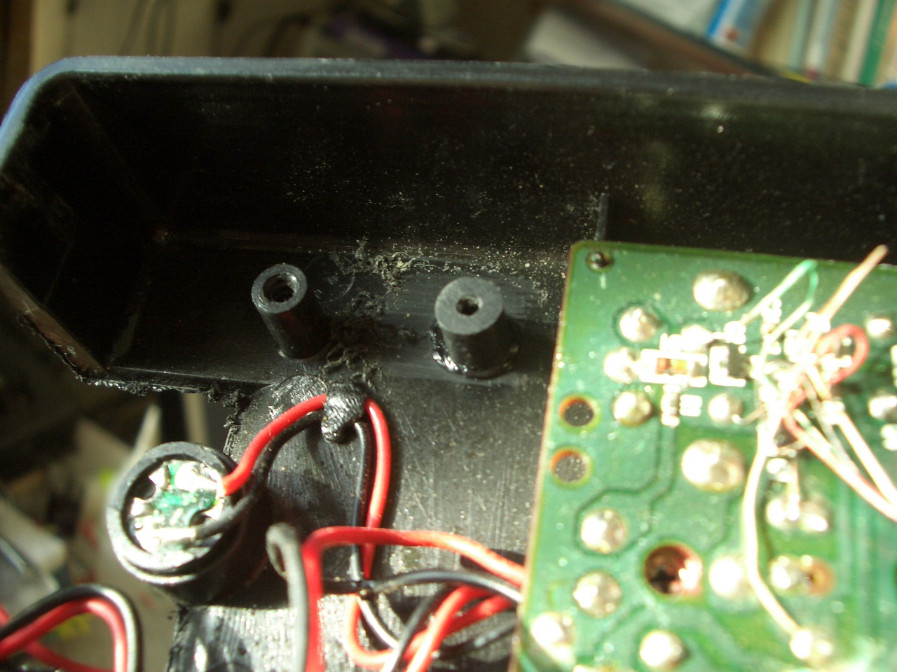

            I will take pictures of it as soon as i get it, I will post anything except pictures of my wife, well unless the price is right. But sure thing I will tear into it as soon as i have it I'm thinking Tuesday i should have it.

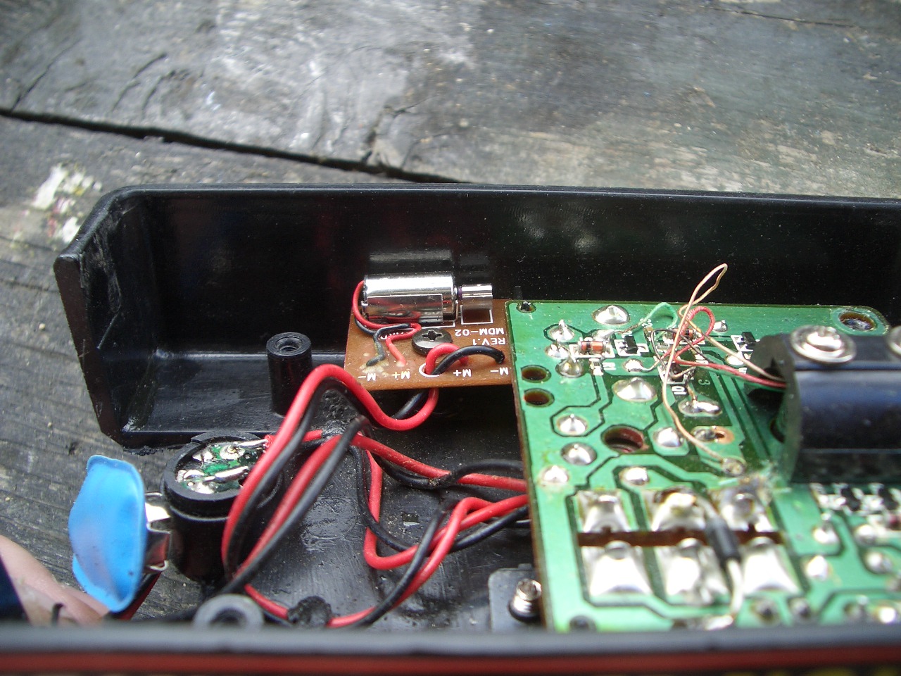

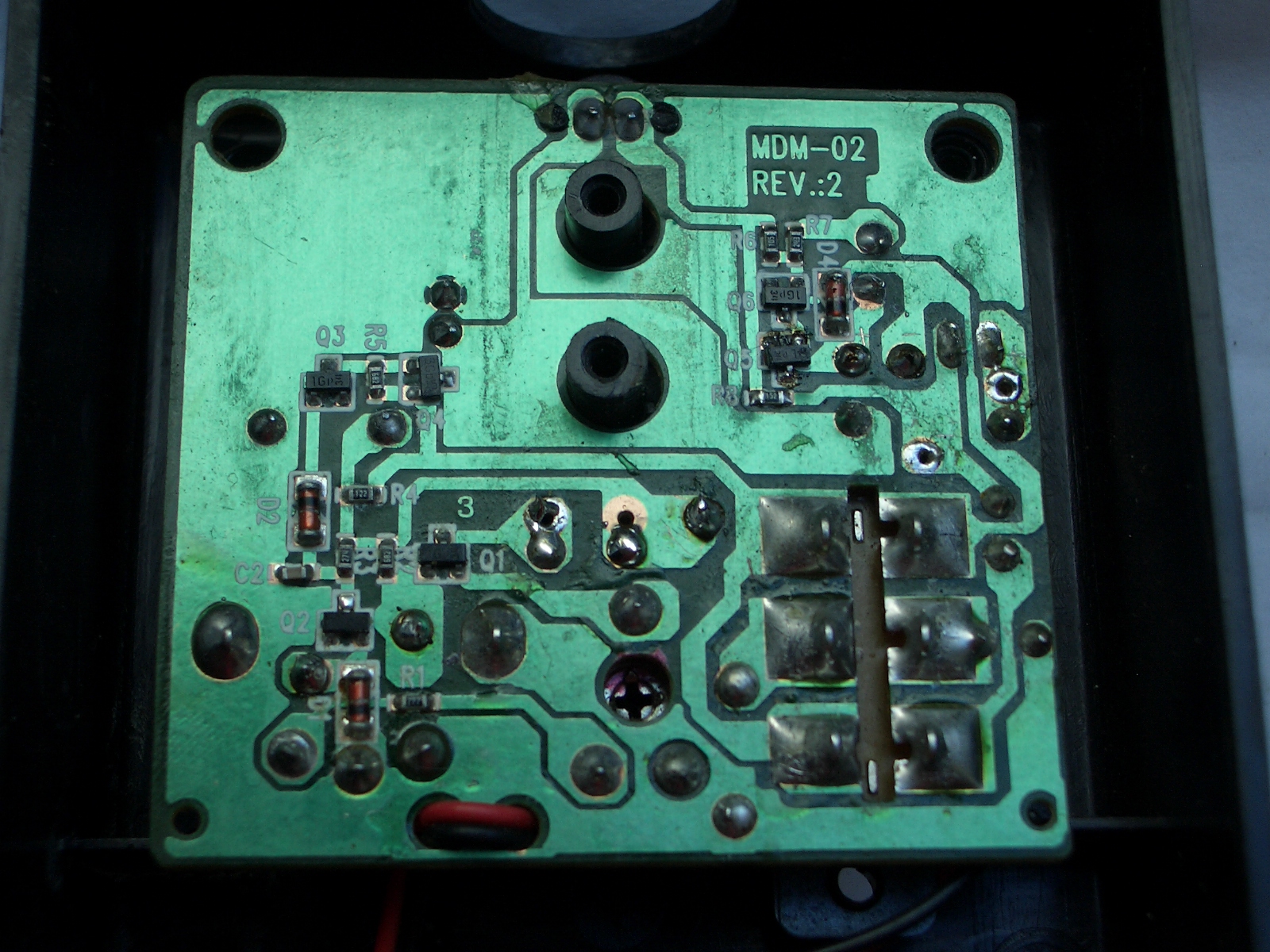

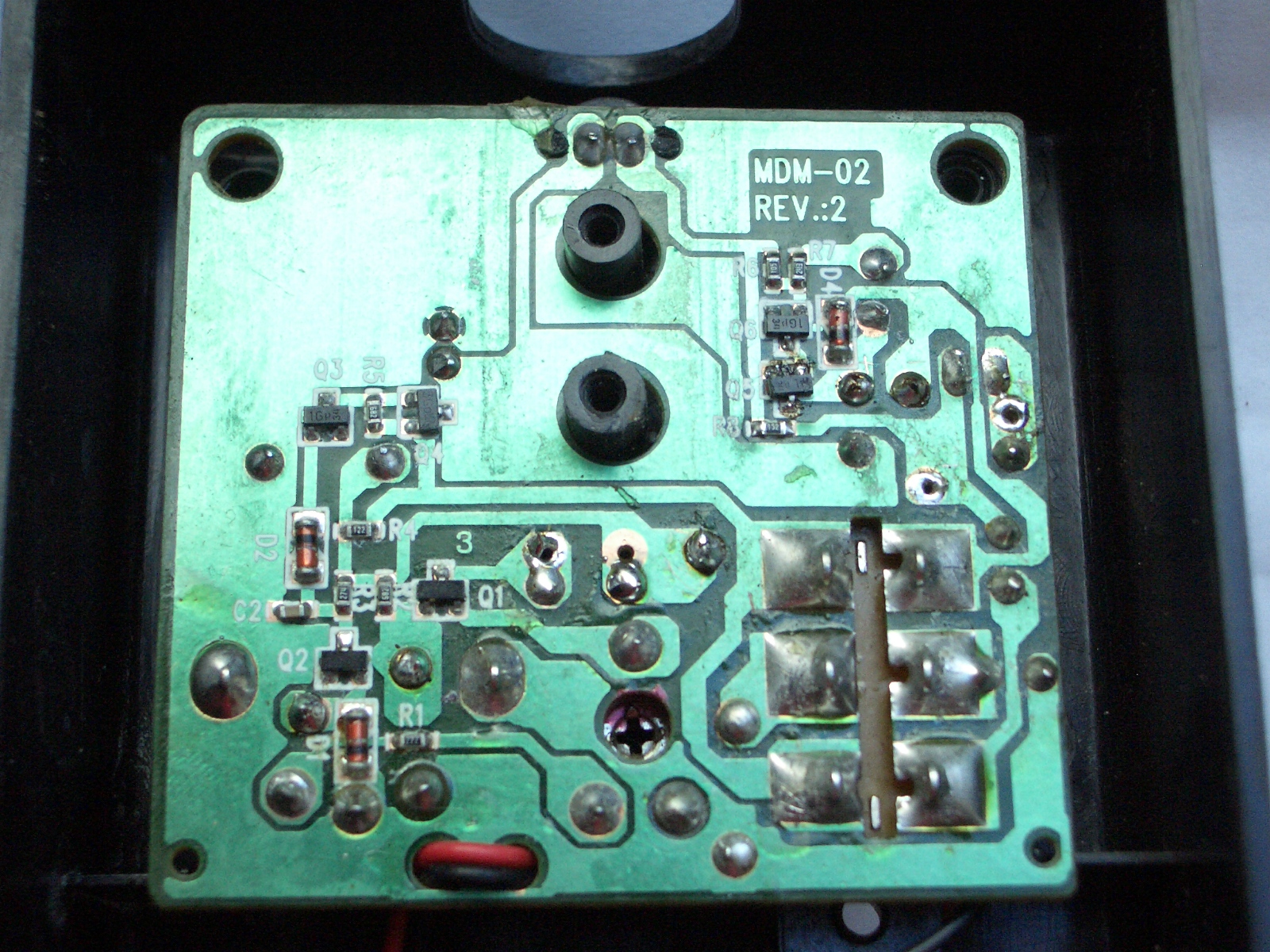

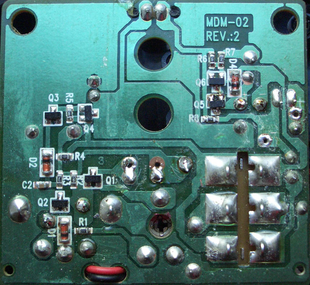

              Well i finally got the pinpointer in mail. so here are the pics i promised.
                where did the guru's go that could help with this project? thanks for looking. BUMP
                  thanks for photos. I do not note differencies there... nothing new on V4 vs V2... it reminds me a politics manner of Tesoro making all their models on one PCB...
                  enjoy...

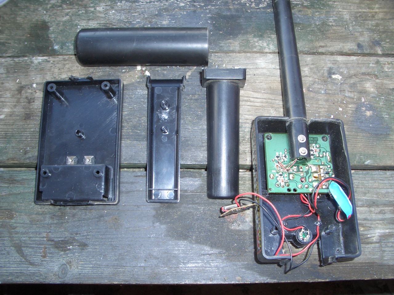

                      I decided to mod it a little i wanted to make a wand type of thing, so i cut off the handle, and then added some wire i got from a CB mic, when i put it all back together it won't work correctly, i made sure that i connected the wires correctly, so my question is the wire that is used for the CB mic is that the problem? can i only use the magnetic wire with this? i would really like to make this a wand can it be done? thanks for looking.
