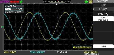

                                HI,
                                How much current flows through the coil DFX?
                                Below is a oscillograph for the coil current... This is BM950 for W5900/6000. Here it is almost 1A.
                                Taktyk
