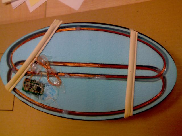

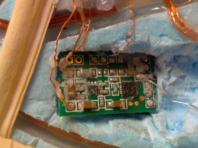

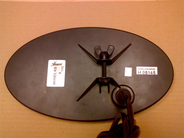

                      in Terra's they use a new superior property - analog-to-digital conversion IN A COIL INSIDE. they has refused poly-frequencied way in advantage oldie-famous GOLD interrelation SIGNAL/NOISE!
                      I don't think X-Terra coils have an ADC inside. They have a micro that tells the detector what kind of coil it is so the detector can select the right frequency, but the coil otherwise operates as an ordinary coil.
                            - Carl
                            I did think in this clue too... one man opened a coil... the all coil has a micro with integrated TX generator and ADC. it is clear... on TX coil is sinusoidal signal 20V AC, on RX coil is also sinusoidal following in the micro. from the chip a signal comes out already as kinda digital, discrete. I changed my opinion...
                              Nice finding KT315. Thanks for posting here.
                              This does not mean that this "ADC" micro solution is so superior over other detectors, but for sure multifrequency solution is inferior at least in domain of common deep range in soil.
                              Maybe this "ADC" has something to do with the so-called coil saturation and nothing else.
