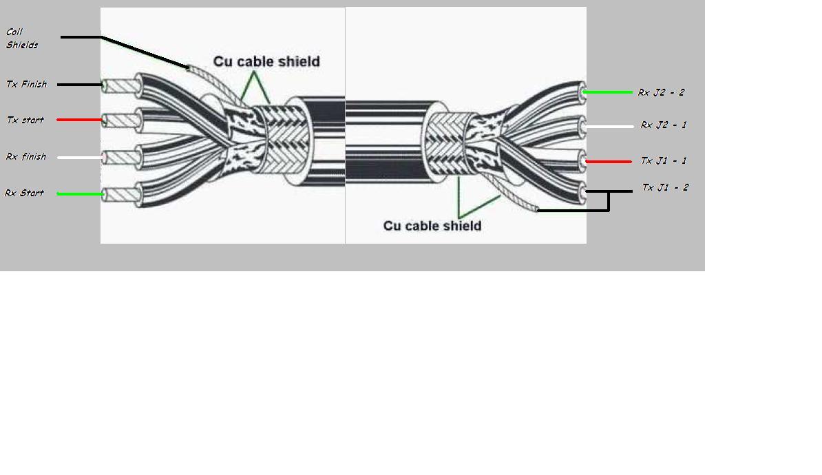

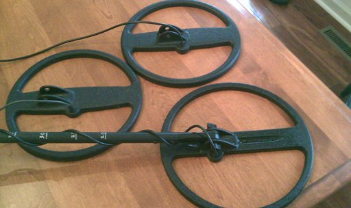

                        • Wet grass problem fixed!
                          Over the last 2 weeks, I built 2 more coils, trying to independently determine what the best shielding and grounding configuration might be to deal with wet grass. Having 3 coils that worked very well, they all suffered when the sun went down and the lawn was dew covered.
                          I put all theory aside and went with some trial and error.. Plus what I thought would make sense. A little costly I think but did come to a solution which works best for me.. (your milage may vary).
                          Never mind what I tried and did not work.. it doesn't matter. What finally DID work is this:
                          A USB-2 cable, using all 5 conductors (2 power, 2 signal + ground).
                          * RED and BLACK wires to run the Tx coil (since they are a heavier gauge).
                          * GREEN and WHITE for the receive circuit.
                          * Rx and Tx shields tied together in the coil and wired to cable shield.
                          Cable shield is then tied to ground on PCB.
                          * Rx and Tx coils NOT connected to ground inside the coils at all.
                          In other words, all active parts of the coils do not touch the grounding
                          system in any way.. Only the cold end of the Tx circuit is connected to
                          ground on the PCB.
                          Null was less than 100 mV at pin 7 of U101a but climbed to 300mV when epoxy cured.
                          Best airtest without chatter on 1e is 31cm with latest coil.
                          Best airtest without chatter on 1e with coils wired per TGSL coil making by Ivconic is 35cm (indoors).
                          Depth test in hard packed clay test garden. 16cm for .58 Cal minie ball. Same for all 3 coils .. about the same as my Shadow X5. ($935.00 machine).
                          I know that some post will agree with my wiring configuration, some will not.. These are just my findings.
                          I also vacuum formed a new shell and managed to shave 3 ounces off of my previous coil (the one closest to the bottom of the picture..

                            Attached cable diagram..

                                That's very interesting. Maybe worth having two different kinds of coils depending on whether grass or not. Would you prefer original (Ivconic) wiring for beach for example?
                                I like idea of red and black for TX - also because white and green often twisted pair in good USB cables, good for low noise for RX.
