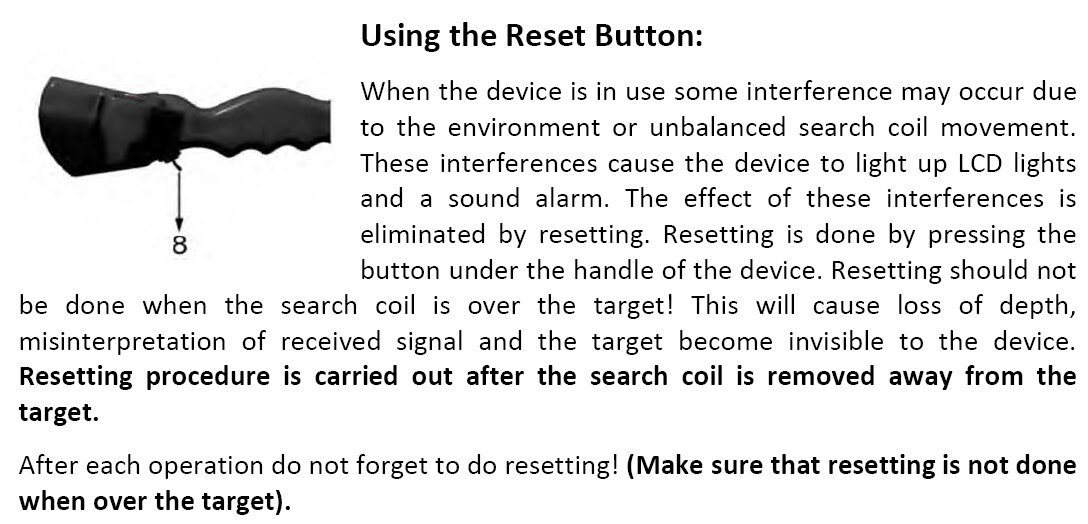

                  • @ syed ayub basha
                    > Sir you modifies all this for what purpose, tell me.
                    Improvements and technical development!
                    As example your Jeohunter 3D now has
                    "reset button mod" as a standard feature.
                    If you have more experience, it is very easy
                    to check with it even at high sensitivity if its a
                    real hit or the cause of ground mineralization etc.

                      • reset button & cavity info
                        @ syed ayub basha
                        This is from the Jeohunter instructions manual
                        you can download from the above page as pdf.
