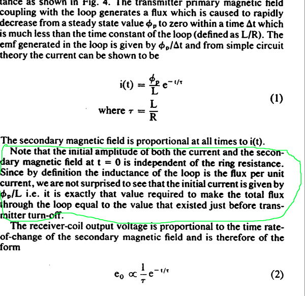

          This statement on page 3 doesn't seem believable to me -- regardless of resistance, the initial current is the same? How does he get that? It almost seems like he left a term out of the solution. But I'm beyond rusty with E&M equations.
          -SB

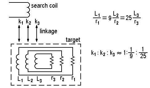

            SERIES OF TIMECONSTANTS
            Hi all ... what is the best target simulation for LTspice.
            I use a an inductance looped with a small resistance but does anyone have any good / realistic models or this OK ????
            My simulation detects a 0.1 nH inductance with 1 ohm loop resistor. The main coil is 300 uH. Any comments ...
            Hi Moodz,
            Here I propose not the best SPICE model of the target, but it predicts experimental results with a coin at error below 40% in HF region. The coin is presented as two time constants with ratio 9:1, ie the second time constant is 9 times smaller than the first (fundamental) time constant. The mutual inductance between search coil and the second eddy loop is also 9 times smaller than to fundamental loop. For example if the fundamental time constant is TC1 = 3,6E-5s, then the second TC2 = 4E-6s and if linkage coefficient k1 = 9E-3, then the k2 = 1E-3. However, if the target is like gold nugget, the k2 should be larger than 1/9 of k1, for example one eighth to one seventh and appears influence of the third timeconstant.
            For more accurate modeling, even at coin should be introduced third time constant, which is 25 times smaller, as shown in the attached equivalent diagram, but no simulation benefit from such complexity.
