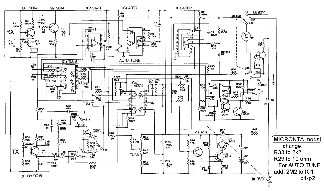

      Hi Qiaozhi, in the circuit diagram Micronta 4003 posted by you in 08-21-2007 there is the following handwritten text:
      "Change: R33 to 2.2k; R9 to 10 ohm
      Auto tune: add 2.2M to IC1, p1-p2"
      The manufacturer has made such a modification or it is a proposal from someone else?

          I don't know who added the notes, but I doubt they came from the manufacturer.

                          Jsarno, if you can not make changes described in this chematic, ask someone to make them. For that purpose take three 1 / 4 Watt resistor: 2.2 kiloohm, 10 ohm and 2.2 megaohm.
