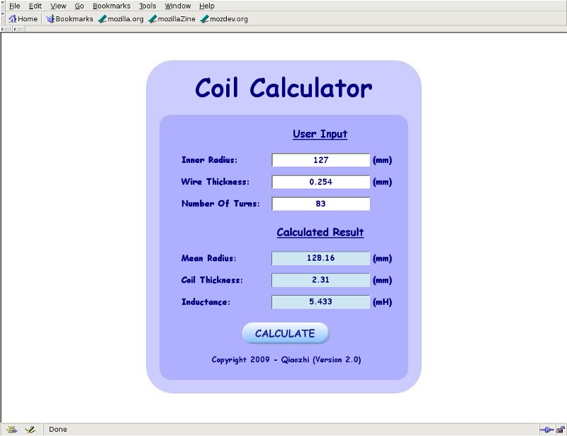

                  It depends what TX frequency you intend to use. To calculate the number of turns you can use this calculator.

                        It's an air coil calculator and assumes a square cross-section. This is more accurate than the usual solenoid formula.

                          Ah okay... Thx! I wanna use 10kHz. Hope this formulary works at this frequency?!

                            If you require a transmit frequency of 10kHz, then let's assume a tuning capacitor of 47nF. In this case the coil inductance needs to be 5.4mH.
                            As an example, let's say that we have 30AWG (0.254mm) wire available, and we want to wind a 10" (254mm) diameter coil. Please see the calculator image below. Of course, this is just an illustration as you've not said which type of coil you're planning to use - DD, concentric, omega, OO, etc.
                            The result for this example is 83 turns, which gives an inductance of 5.433mH.
                            Then you need to perform the same calculations for the receive coil, based on the coil type you require. Don't forget that a concentric coil will also require a nulling coil in series with the TX coil, so you'll need to take this into account. If you want to build a DD, then you'll have to fudge the values to account for the change in shape as you form the D shape.
                            Good luck!

                              Thx, that's even more accurate. I built up housings for three different coils. So I'll try the coplanar (concentric), and DD in three different sizes with varying frequency.
                              My problem is, how can i assume the capacity and at least the inductance? Isn't 5.433mH is much? I thought about 350uH...
