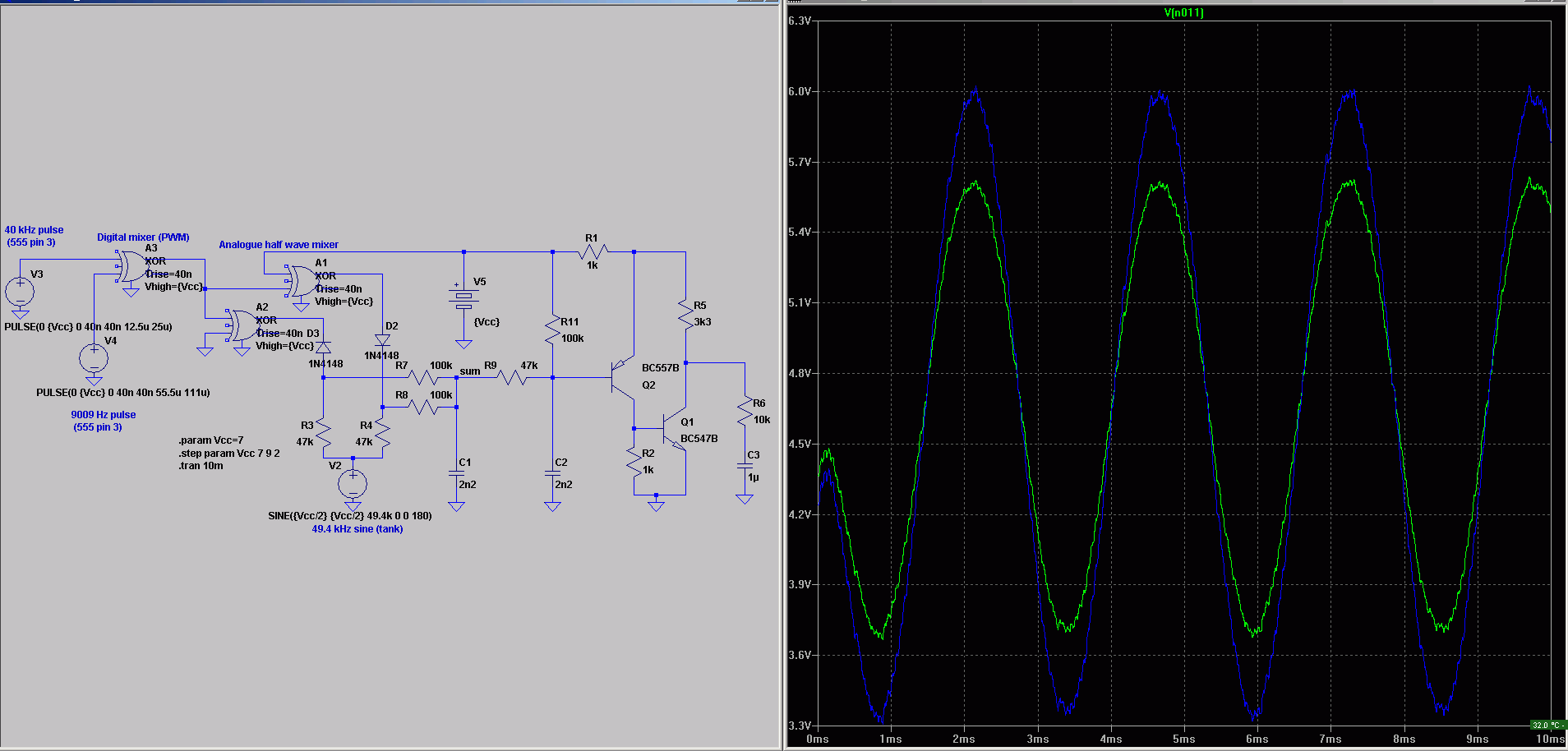

    Here comes the mixer. It might be confusing at start, but it is not, I promise.
    I need sine to work with notch, so I have to mix sine wave obtained at the tank. I also want to avoid mixing analogue signal twice, so instead I'm mixing two digital signals, and obtain PWM product. It has no low frequency components, so it does not impair resonance of a sine wave tank (I guess).
    The resultant signal is 1Vpp pretty pure sine, so notch will work. I put some amplification here, however, It is just because I wish it to remain a seventh grade project. It can also be tumbled around and use opamps.
    Simulation is prepared for 7 and 9V supply.
    Only one part is missing, 555 oscillators.

      What is your complete idea? Can you post something like a bock scheme of your design?
        Only oscillators are missing, but I'm sick, and not up to completing it at the moment.
        A whole idea is combining two tank oscillators, much like the matchless, that are producing frequencies far apart to completely avoid synchronisation problem. A third RC oscillator is used to reduce the beat frequency into a more sensible range ~400Hz. Mixing is performed in a way that the resultant 400Hz tone is a pure sine, and it can be notched out. So, in absence of events you enjoy silence, and in case there is a metal it produces tone. Easy.
        Traditional BFOs use one tank and a local oscillator. Matchless showed that it can be done otherwise, and I like the concept.
