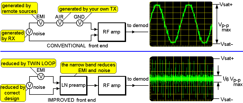

          IMNHO the ideal output voltage of RF amp for metal detecting is near to saturation. At this condition, it operates at maximal gain, ie metal detector has maximal sensitivity. If the opamp is ideal, voltage swing in output should be maintained allways near to rail-to-rail voltage. To achieve this, you need AGC (automatic gain control) for preamp and ABC (automatic balance control) for input.
            Ideally zero! But you'll never get there.
            Carl, the attached image shows how should operate front end of a competent designed metal detector. The image was posted in your forum.
            http://www.geotech1.com/forums/showp...71&postcount=7
              greetings...
