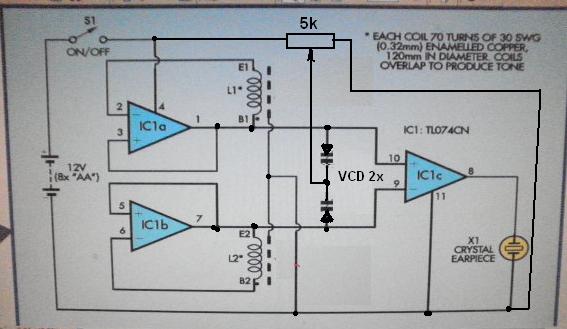

    ... How could I replace the 100pf tunning cap, for a pot.
    I hope to more technical and less emotional answer from our coleague mikebg.
    Variable capacitors are relative unstable (not only by temperature but physicaly too) elements in oscilator circuits, so it is reasonable if one wish to replace it by a little more stable elements.
    In disputed schematic we have analog oscillator circuit and there is no simple replacement variable C with pot R, if we want to maintain the equal same features of the device.
    To avoid variable C (or variable L or Xtal) maybe we need to go digital like this solution ( http://mediaexl.blogspot.com/2009_09_01_archive.html ) :
      Dave,
      You can make a variable cap using a varactor, which is basically a diode with a high voltage coefficient for the reverse capacitance. You then use a pot to apply different voltages, resulting in a variable cap. The problem in this circuit is, the cap is applied differentially, so a varactor approach would be tough to do. Looks like Maikl found the better solution.
      - Carl

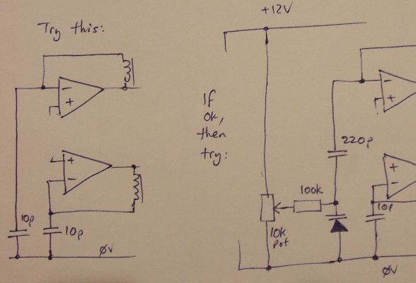

          Solution as Carl suggested (not exactly one resistor replacement):
            You could try adding two 10pF capacitors from pin 2 to ground and from pin 6 to ground. If the circuit still seems to work OK, then try replacing the pin6 cap with a varicap diode. The diode anode goes to ground, the cathode to pin6 via 220 pF. Then apply the reverse DC bias to the cathode, for example put a 10K pot across the 12V supply, and take the wiper to the diode cathode via a 100K resistor. The varicap needs to be the 2 -20 pF approx. type. Worth a try.

                Seems my previous attachment was an epic fail, so thought I'd try again.
                  Thanks Skippy, when im in the workshop next I will try it and see what happens, keeps the brain active.
