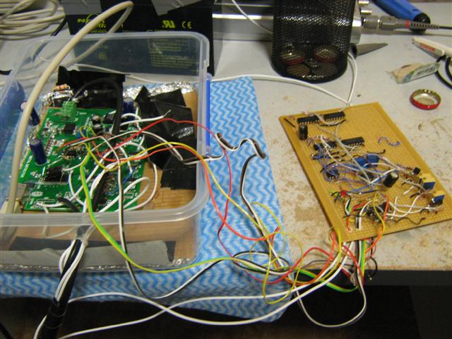

              Been working on it
              I haven't given up..
              I have been working on it, like a machine .
              What a complicated nightmare...but.
              After some circuit changes (that I will post), it is starting to work.
              I have it auto-zeroing so.. must be waved over a target to detect it
              I was able to give it a quick test tonight (outside on ground), it is very quiet, but gives a nice clean signal on a tiny Aluminium rivet head (~10cm distance)
              Looking like an improvement on the other system. It picks up smaller targets mostly due to the coil and sample timing.

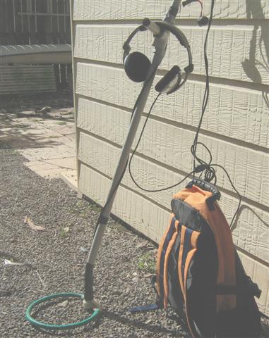

              The coil is 'Faster': Less turns but slightly larger in the same style as the last coil.
              (will post pic)

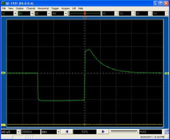

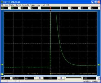

              I have found for anyone that doesn't already know the most important things in a PI system beside the coil are:
              Damping resistor: Make it perfectly matched (use an oscilloscope, I just got a USB digitech scope from Jaycar on special, it's great)
              Mosfet gate resistor: If the mosfet switches on TOO quickly can get oscillations and spikes and ringing, if it switches on too slowly, then the mosfet will get warm.
              100 ohms was about right on mine

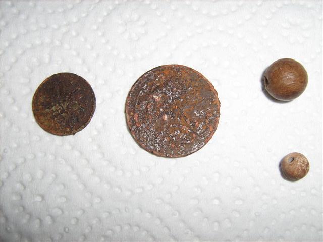

                Field Test (circuit attached)
                Tested in same place I have tested previously (small sandy beach),
                found a new set of smaller (faster) targets.
                20c, 5c, tiny sinker.
                Pictures attached.
                Circuit attached.

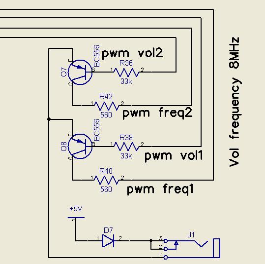

                        I have attached the circuit showing the revolutionary guts of the detector as it is right now. Most of you with electronics skills will understand it.
                        I have been working on Dual audio : Two tones with independent volume (circuit also attached).
                        In Australia,.. typical targets in order of conductivity (lowest to highest) are:
                        Foil
                        5c
                        pulltab
                        Bottle cap
                        Aus 20c
                        Aus 50c
                        copper nickel (AUS $1, Aus $2)
                        Sinker
                        Copper coins
                        So...
                        I Set up the audio like this:
                        Tone 1:
                        Frequency1: if pulltab or smaller
                        Frequency2 Low if 20C or larger
                        Tone2:
                        Frequency3 if copper coin or smaller
                        Frequency4 if really large target.
                        Frequency 1 and 2 and 3 are in harmony, frequency 4 is slightly off..
                        So this means that there are distinguishable sounds for different targets, I will post a movie / demo soon.
                          interesting about the ringing, what voltage are you driving it with ?
                          at what point in the cct did you see the ringing ?
                            Swithcing the mosfet
                            Hi 66666,
                            I didn't measure when the ringing stopped which is a bit lazy, but.
                            I am switching with 10v from a mosfet driver through 100 ohms = 100mA.
                            When I was using 27 ohm gate resistor it was ringing. Now it is not.
                            The mosfet is the IRF720S everyone seems to use.
                            It has a gate charge of 63nJ,..so apparently if I switch it with 100mA, then 63nJ / 100mA = 0.63 uSec.
                            So.. switching it on and off in around half a micro second is fine I think,..the pulses are 100uSec so the switching time is small in the context of this application.
                            The switching frequency is no more than 1kHz and the mosfet is not getting warm.
                            So I figure it is fast enough, and not ringing, it looks nice and clean on the scope.
                            I would like to try to make it as fast as possible..find the perfect resistor, and also understand why there was the ringing/spikes.. but now
                            the pulse is 120uSec, the discharge takes about 100uSec and the on /off edges look straight up and down, nice and clean....
