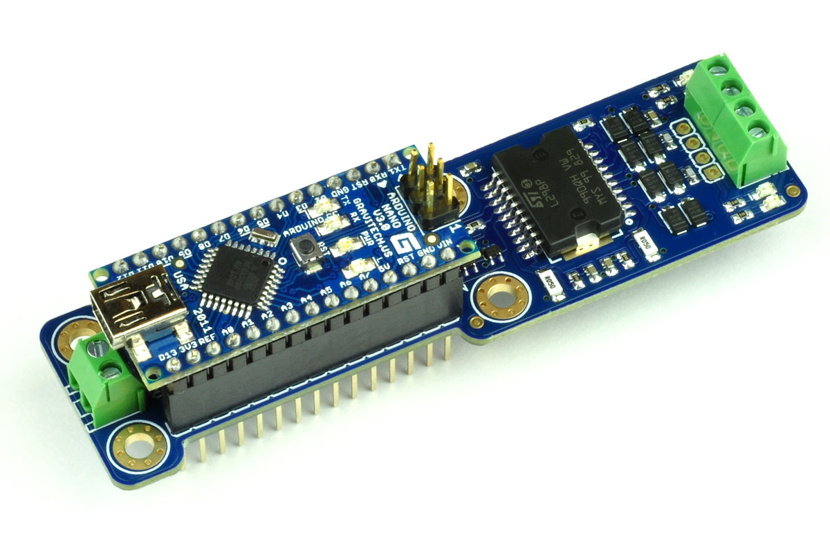

    Hello Foxy, are you interested to layout a Arduino shield pcb?
    • #47
      Hi, bernte_one!
      My english is bad.
      Transformation MD circuit to Arduino shield?

            yes a simple stick on pcb, where you can stick the arduino nano direct on with the pin headers, so that there are no loose wire all around
            • #51
              That could be a good project Bernte_one, I will order a Nano off ebay today and you could share the file on OSHpark, thats shaping up to be a good way to share PCB's, pity you have to order 3 pcb's from them, but if we put up our spares for sale that would be great for everybody.

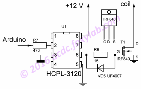

                I want to try my circuit with the driver HCPL3120. I am waiting for the arrival of purchased chips.
                • #53
                  Are you going to use it as a push pull driver for the fet ?
                  http://www.seekic.com/uploadfile/ic-data/200949124818615.jpg

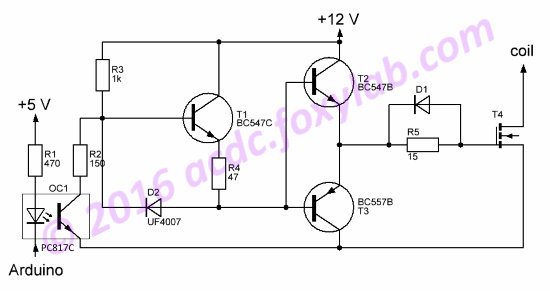

                    You can also do push pull with opto coupler like this
                    http://i.stack.imgur.com/gowYX.png
                      My current driver is too complex:
                      HCPL-3120 will simplify its.

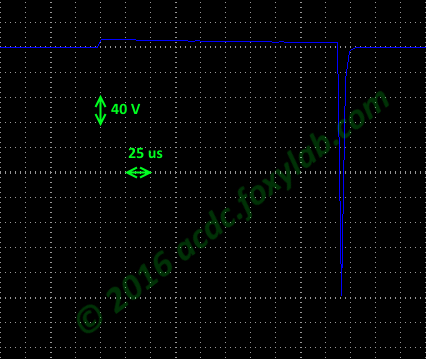

                        Using the laboratory bench, as a digital oscilloscope, I took a series of waveforms for my MD on Arduino.
                        The voltage on the search coil -
                        • #57
                          400V peak, look good
                          whats is the longest pulse you can produce without heating the coil driver too much?
                          • #58
                            I experimented with pulse durations up to 750 usec.
                            P.S. I got a chip HCPL-3120. My current MOSFET driver circuit:

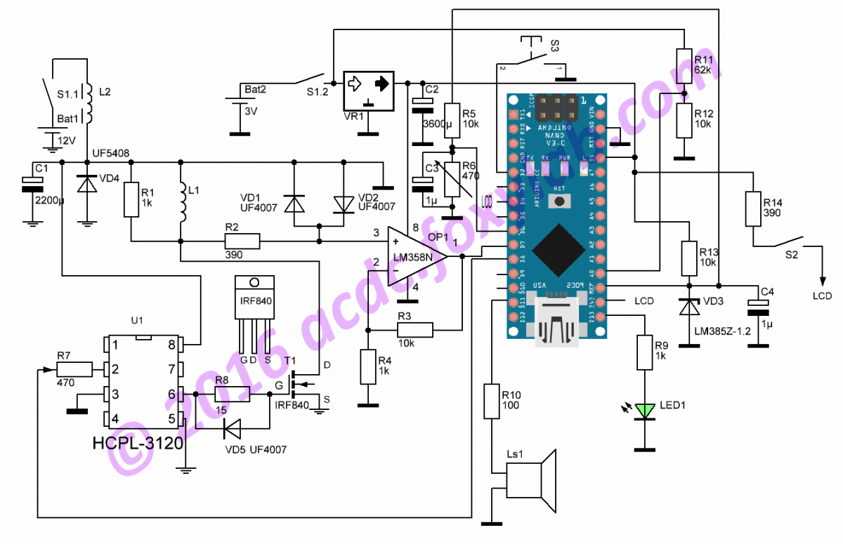

                              My current circuit for foxyPIv2 Arduino-based MD:
                              (description (in russian) - http://acdc.foxylab.com/node/47 )
