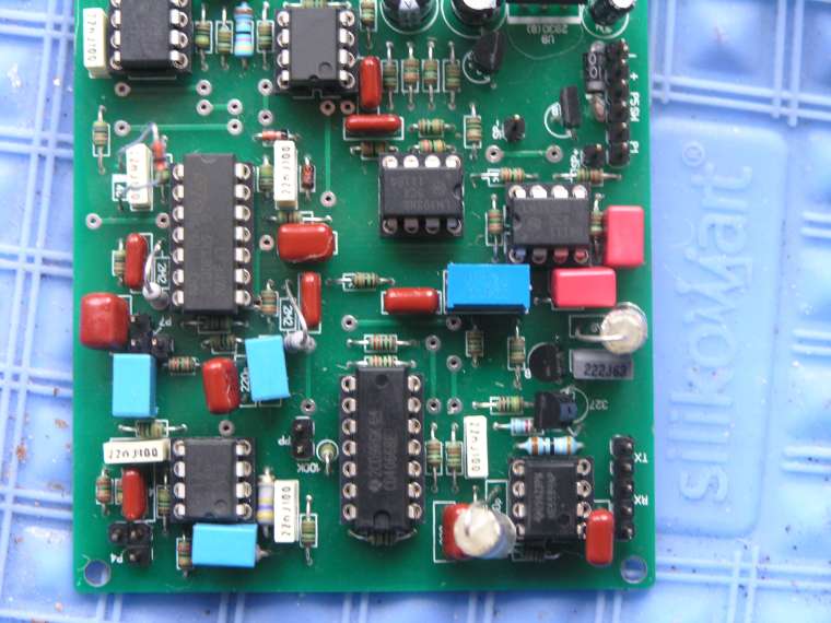

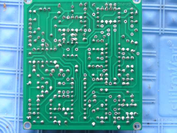

          Can you be certain that the PP CH is live? It appears the Disc CH is going off - this is correct - but the PP CH may have a fault -
          Post decent images of board.
          Can you see a signal on all 3 Channels as you pass a target with a scope or a multimeter meter on ac in Disc mode with the sens full

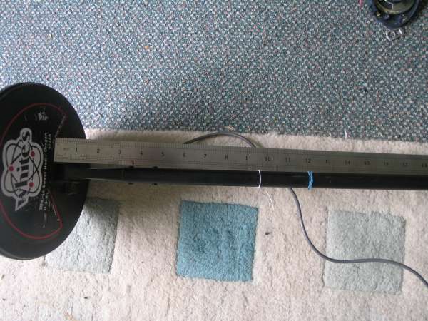

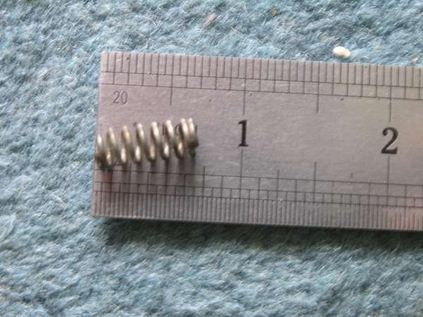

            Blue mark is with the reversed diode in Disc Mode. The white one is with the zener, All metal mode and Disc Mode are the same
            This peg spring was not detected by this detector or original "classic I" now detects okay with the zener 2.7 in all metal mode. Detector is now more unstable and in disc mode you have to be very close to the coil for a clear tone
            • If it is stainless steel - it is kind of expected behaviour. Some alloys of stainless steel do that. More grown-up rigs have problems with stainless steel.
              • Is this pcb one of the ones with the error - where there is a short between two vias?
                The ones which were later sold off cheap
                S
                • No short.
