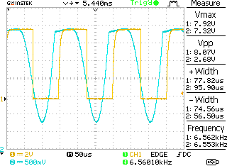

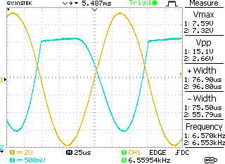

                hi
                ithink my problem in ne5534 - pin6
                please see the pics , BLUE color for all is pin6 ne5534
                1-ref TX
                2-pin1 U8
                3-pin7 U8
                my third file this site canot upload.
                please tell ebout the pin6 ne5534,is it ok???

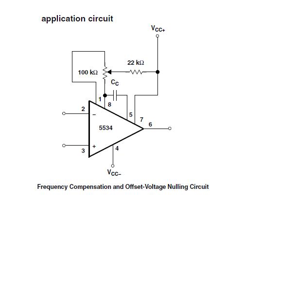

                • You have a large DC offset at the preamp output of at least +3.5 volts.
                  That why the Rx signal looks clipped - its saturating on the pos rail..
                  This needs to straddle the 0V position
                  Make sure the rails are +4V and -4v WRT the copper around the cct board edge.
                  I dont know what you have done here to get this.
                  Put some good 2Mbyte images up in good focus with natural light and we will all try to help you
                  You could force a better DC offset condition like this...
Name:	offset correct.JPG
