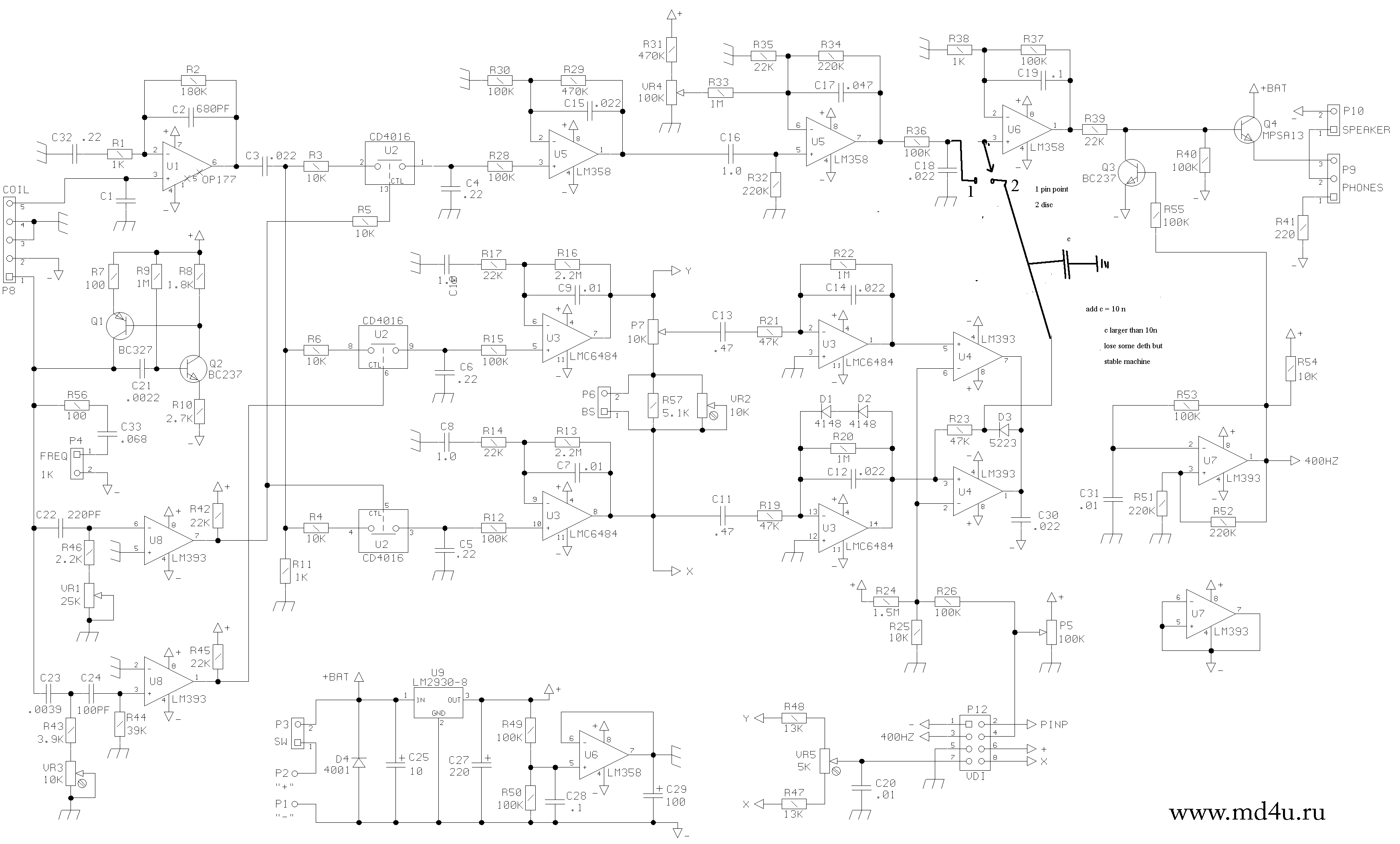

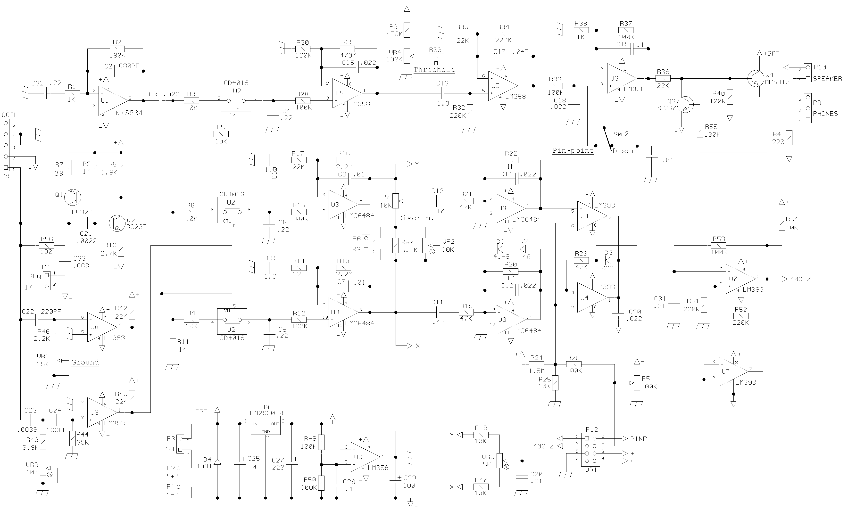

          • i found the problem 4066 cannot switch high dc voltage ( above 3.5 volt ) i replace the switch between disc and pin point by toggle switch and it work even better
            • Originally posted by ossamaussama View Post
              How did you change the PCB?
              Can you put a picture montage changed?
              Or a scheme with changes.
              Regards Gaby

                • That's corect ?
                  • yes correct
                    • it is better than using 4066 in this part
                      pinpoint completely separated from discriminate mode
                      so the device less noise

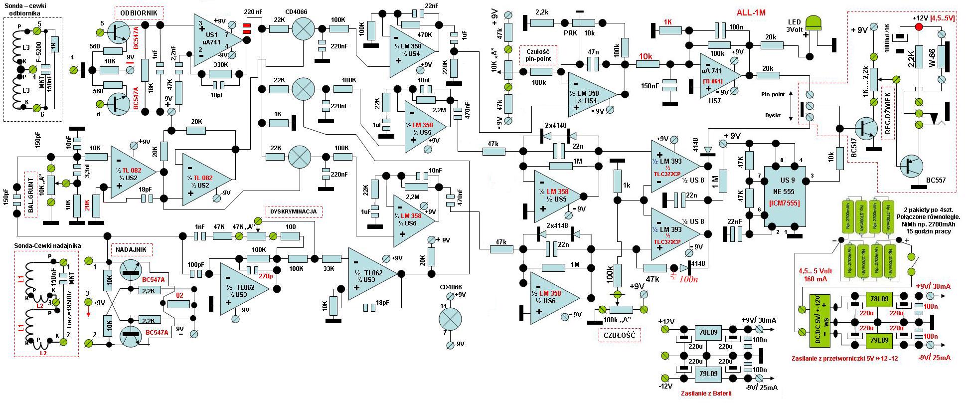

                          I found something similar (name All 1M) a Czechoslovak site.
                          As a principle scheme is almost IDX.
