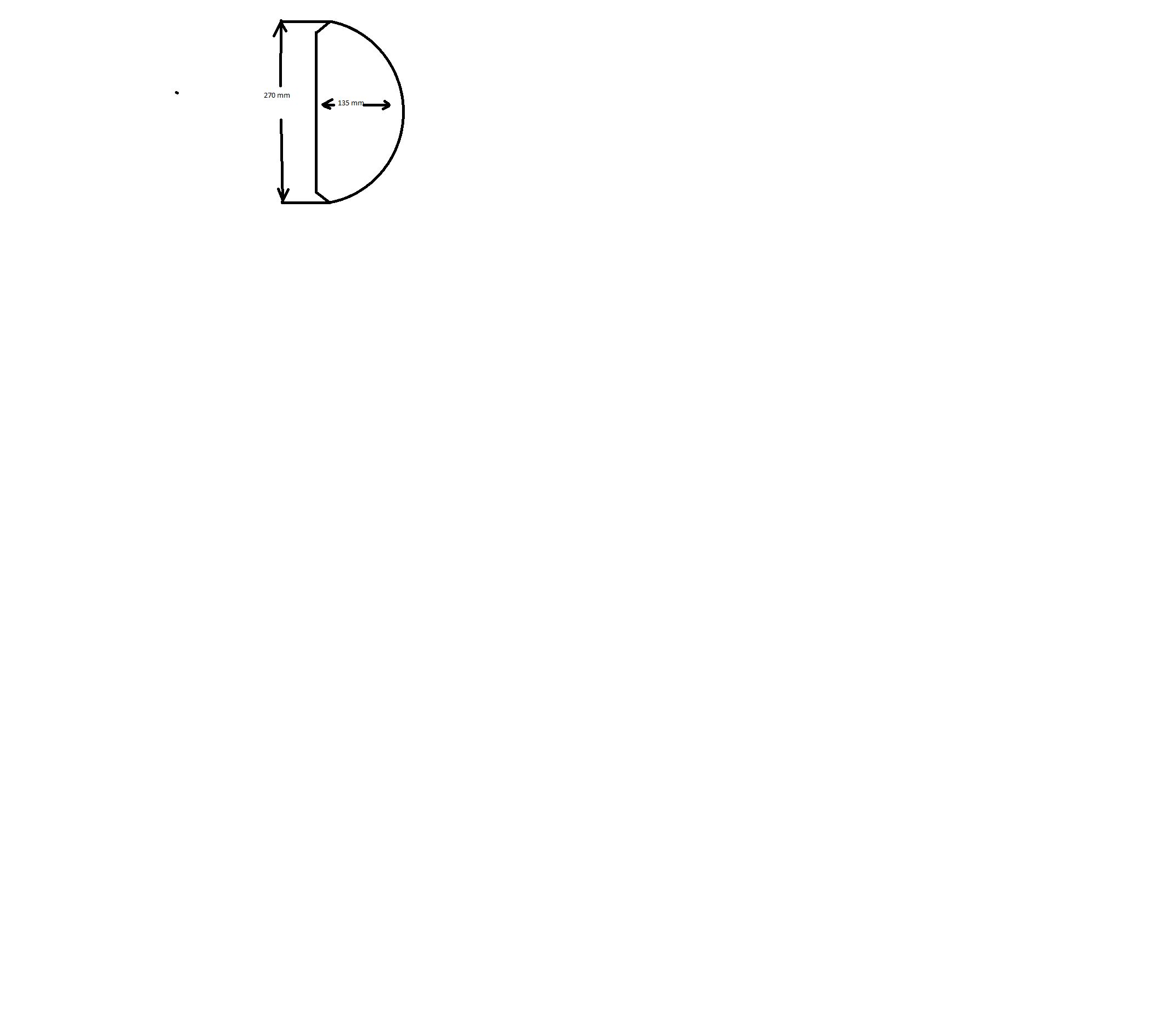

                          • Upgraded unit with a transmitter on quartz and switchable frequencies 7 and 14 kHz. https://www.youtube.com/watch?v=wDmO76VpfX0&t=0s
ID:	346344 DD coil 27cm and correct
