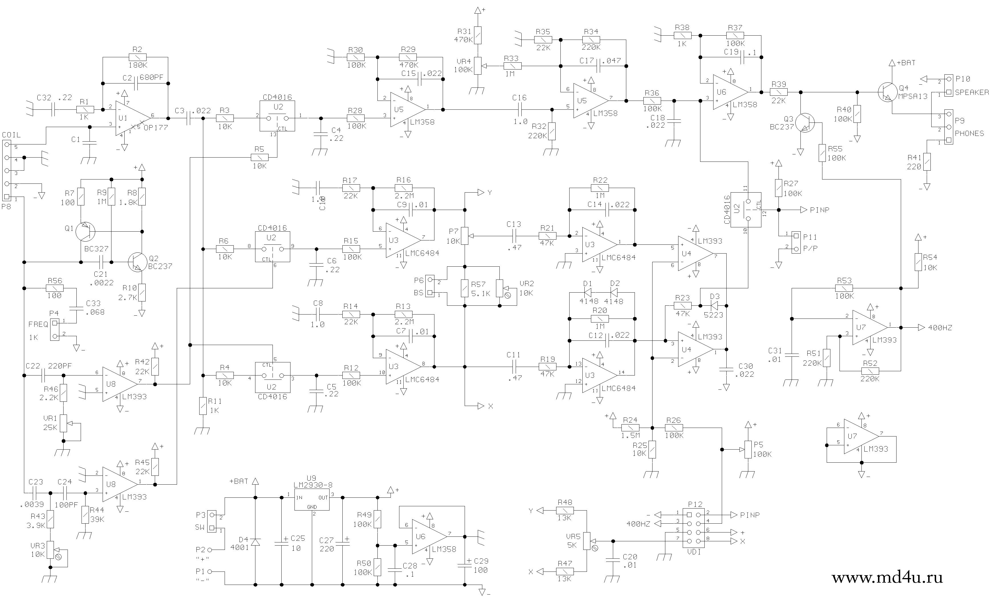

                Eduardo, You have posted 3 different circuits, Is this connected to a IDX?
                Which one of the circuits is used in your latest youtube that shows the steel beer bottle cap hitting a low tone? thanks

                  It is my IDX-PRO. The circuit layout is the last file I posted and working properly. The penultimate does not work. I have no schematic, I have only Layout.
                  That is what works.
                    That is what works.
                    Sorry, I dont quite understand, Do you mean that using your latest 2 tone circuit that it disables the pinpointer function on the IDX?
                    • Only the last circuit works very well. No pin-point off. The pin-point working properly.

                        Great work (as usual!) Eduardo, many thanks for suppling us with the infos and a board layout as well.
                        I have a question about the solder pad marked "Collector", can you tell me exactly where it connects on the main circuit board.....I am going to try and make a schematic and a PCB using Eagle (I am a bit rusty!!) and I want to be 100% certain as to where it is connected.....is it also going to IC4?
                        I was also wondering if it was maybe a good idea to move the IC4 onto the extra PCB? and run short wires from the mainboard? What do you think?
                        Regards and thanks from
                        Andy
                        • 1-U4,2-U4,3-U4,12-U2,1-U6,COLLECTOR-Q1. All that is connected to circuit board of IDX-PRO.

                            • Originally posted by ZTDMP View Post
                              This works better.
                              ZTDMP, well designed circuit diagram (post # 330), but it should contain a capacitor connected across TX coil.
                              A center tapped TX coil with 1uF MKP type capacitor will increase transmitted power.
