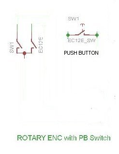

    These are correct. But... What type of rotary_pot must I buy? :-)

      • Originally posted by szucs_g View Post
        Sorry! I didn't see You question...
        .......As against a slider pot?
        What is also important to know is Log or Linear versions......
        Andy
        • Hi
          I used this rotary encoder pot:
          http://i1226.photobucket.com/albums/...4/DSCI0064.jpg
          I don't know its type. Rotary encoder pots are not linear or log. Rotary encoder pots generate clock pulse.

            Rotary encoders are not pots. But they can be used to encode a resistance when correctly used with other components.
            As the word encoder was not previously mentioned, it was difficult to help.
            Now its cleared up properly.
            Andy
            • Originally posted by elbombaci View Post
              I tell You, my friend, the type is ED1112S-20.
              http://home.comet.bg/datasheets/Buttons/ED1112S-ok.pdf
              • elbombaci
                would you mind explaining the connections to the encoder thanks
                    In Hungary, 24-step encoder can be taken. Previously, I wrote in the web shop are available. There are push-button, which should be here. There will be no problem if you do not pass 20 of the encoder?
