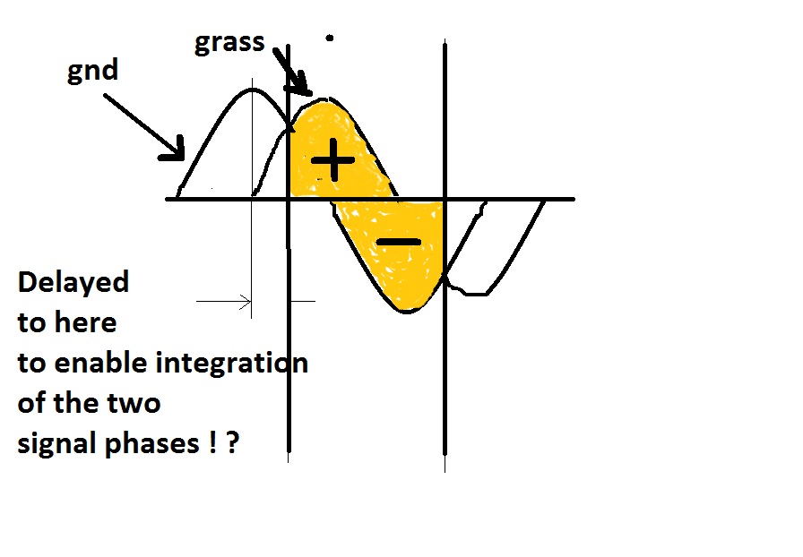

  • 1 Confirm what I suggested is actually what is happening.
    2 Identify the phase of the return of the wet grass/
    Your guess is as good as mine for a solution.
    We either bodge existing hardware or redesign.
    We could add another channel and dedicated phase shifter for wet grass. Feed both geb and grass outputs to a unity gain summing amp then output result into instrumentation amp as before.
    May be difficult to align in use. Geb on its own is enough.
    IT May be possible to integrate both GEB and grass signal to zero.
    - If the phase of the grass signal occurs after the gnd signal phase, then if we could delay the gating pulse to cover that phase also.

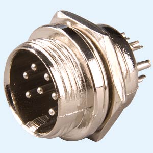

                  • if someone want to connect an original coil to the idx and would not change the plug.....
                    I've experimented a little time and i have the solution for the problem.......
                    the 7-pin socket of the known connection system is it very good.
                    you must remove a 2 pole and the original plug fits.

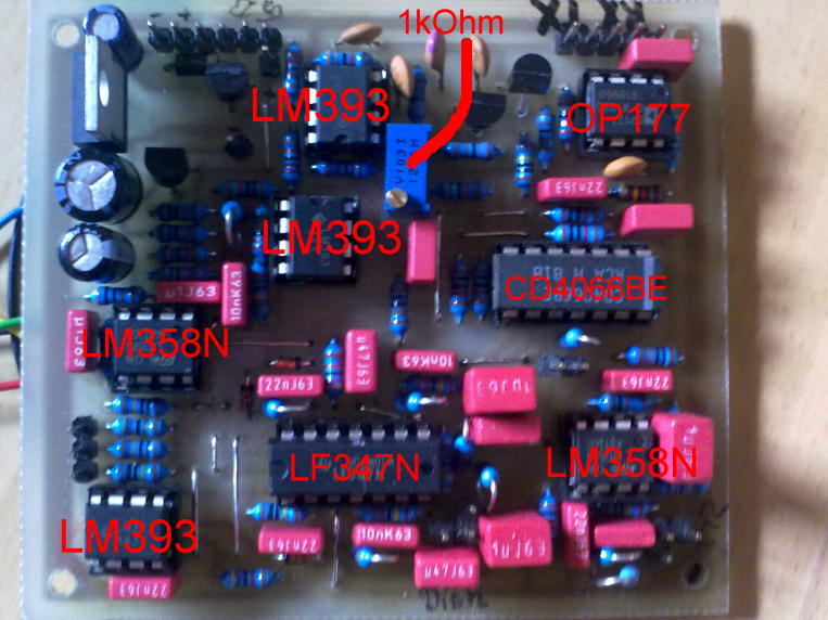

                          • hello all,
                            Last week I got my original coil. the bluemax950. But even with this my idx does not work. But I can not find fault. pinpoint because if I hit, I can hear a tone. when I turn the treshhold, this tone louder. I measure the correct frequency on tx-connection. changes in the last layout I did not yet. are the parts would still be the first layouts in there.
                            maybe someone has an idea? or can give me some values ​​that I can measure it in the circuit?
                            regards, marc

                              • Originally posted by Schatztaucher View Post
                                hello all,
                                regards, marc
                                You have to replace the resistance of 47 ohms for a 1K potentiometer. Your LF 347 has too much gain and so gives a constant sound. Happened to me just like you. To put a potentiometer 1 K, you can adjust the gain so allows.
