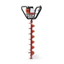

                  dig 10 holes a day easily
                  just use this

                                Originally posted by joecoin View Post
                                just use this
                                I don't think this is legal in most places.
                                Monolith
