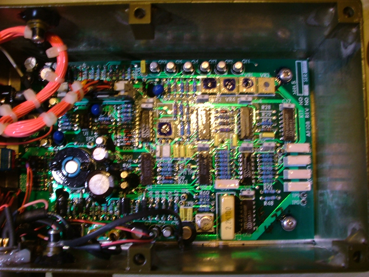

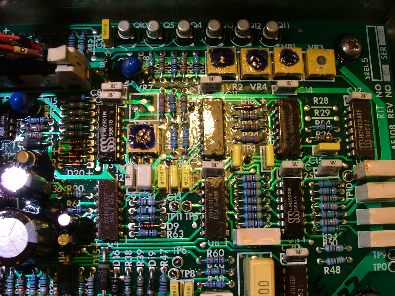

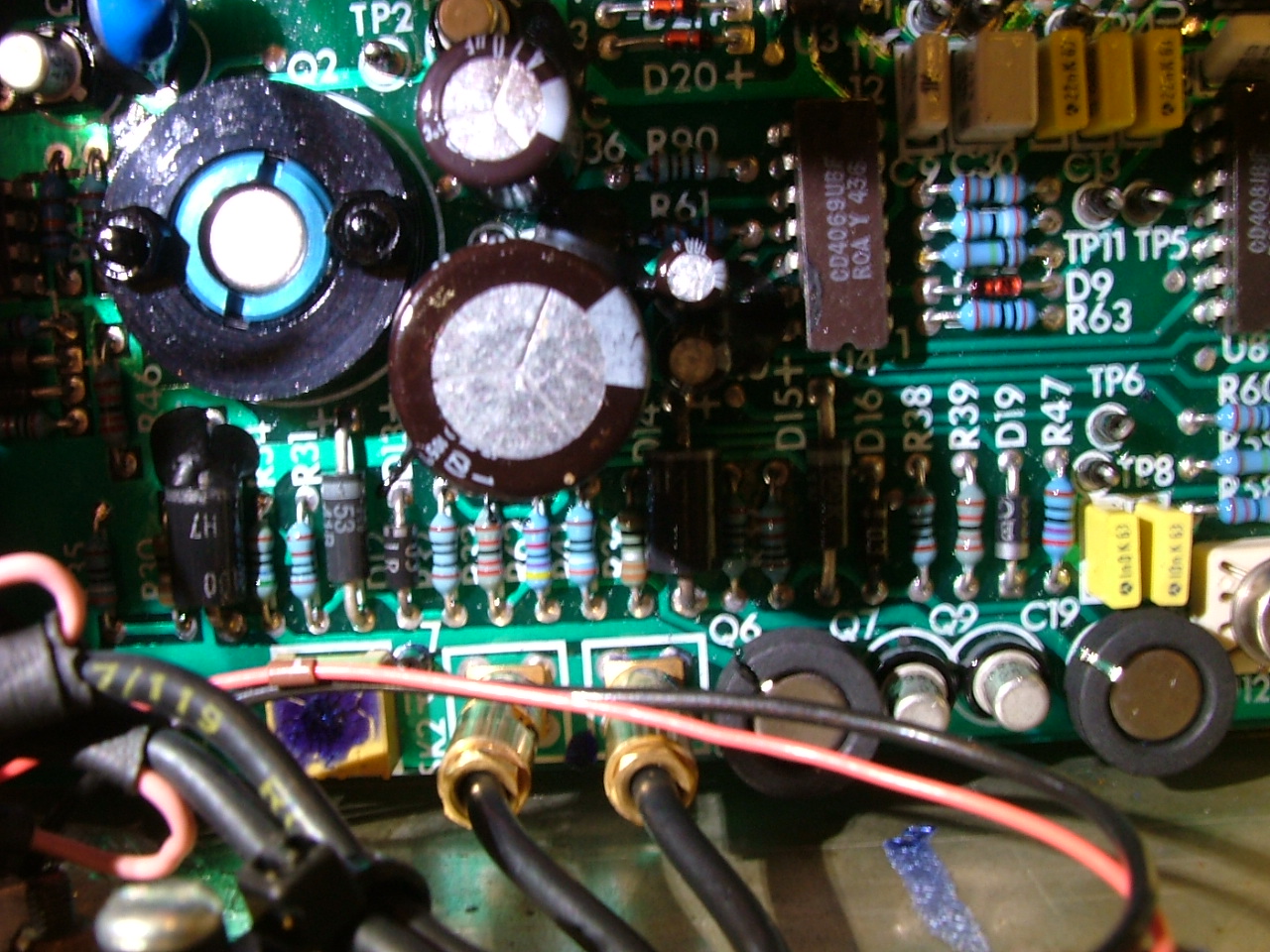

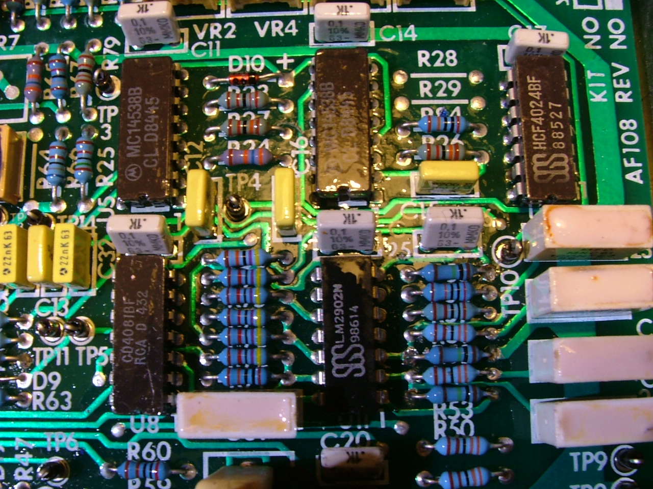

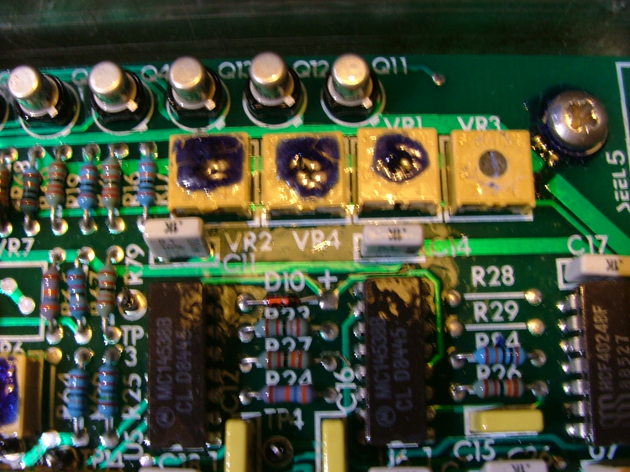

    I have a PI unit that has poor performance,on the board it has 6 trimpots. I have not been able to get a schematic yet. How do you go about identifying the pots and what they adjust to tune this machine for better performance? Right now the machine is only useful to find plow points and sickle bar mower blades,not sensitive to coins at all. I can post Pics of the circuit if anyone wants to take a crack at it.
    A pic of the PCB might help identify it, then a schematic could follow.
      Here are some pics
      I can get in closer just tell me where.

                        Hello Everyone . It sure looks like a Whites AF-108 made for Europe ?
                        I never saw a schematic but there are several photos of this PI machine buried in this forum somewhere .
                        Regards.............Eugene
                          Finally found the schematic, I need to scan it tho.
                            Uploaded the schematic in the "Schematics" forum. Enjoy!
                              Now its in my court
                              Now I have to find which pot adjust the sample delay time I think.Im going to be looking at that schematic for a while.I think I will have big one printed at kinkos.Thanks a million Carl.
