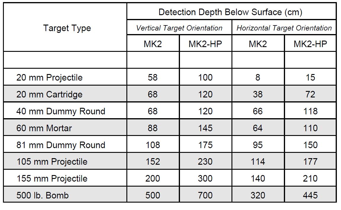

          Thank you mikebg, but i don't want to detect small target such as coin .I ask all , do you know a detector to detect a metal (30*30cm) in 3 meter depth????? i need to detect in 3 to 4 meter depth.pi system can not detect in 4 meter depth and TR/RX system can not detect and vlf metal detector can not detect too, only GPR can detect and GPR is not metal detector and can not detect in rough terrain.for your opinion what i do ? I attach the penetration depth size of EM61 please lookand i did not buy. only I just ask all user

              This equipment is designed to detect unexploded ordinance (UXO) devices. Is that what you're searching for?
              HI Qiaozhi
              Thank's of your help.but do all EM system is to detect unexploded ordinance?or the EM61 is therefore?
